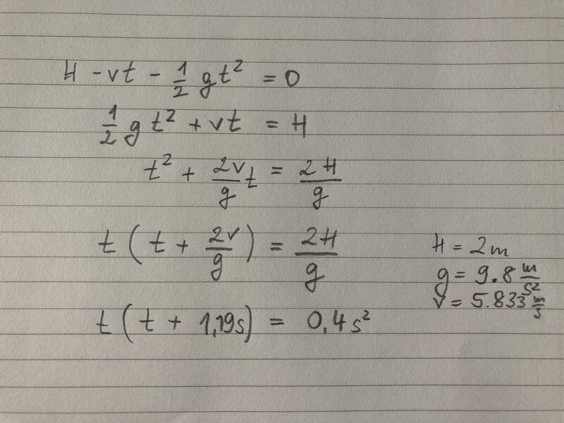

A falls from a height of 2m with an acceleration of 9.8m/s2 down (free fall).
B ascends with a constant speed of 5.833 m/s
When do A and B hit each other?
Thank you very much for the help.
Gunnar
DofA = D0 + 1/2at^2
DofB = vt
DofA = DofB, but how do I solve this?

A: Distance = 2m - 1/2*9.8m/s2*t2
B: Distance = 5.833m/s*t
A: Distance = B: Distance
2m - 1/2*9.8m/s2*t2=5.833m/s*t
The question is now: how do I solve this quadratic function? All my attempts do not make sense.

2m - 1/2*9.8m/s2*t2=5.833m/s2*t
1/2*9.8m/s2 * t2 + 5.833m/s * t = 2m
t2 + 2*5.833m/s /9.8m/s2 * t = 4m
t (t + 1.19s)2 = 4m
Something is wrong, isn't it?

My result is 1.19s
1.19s does not make sense, because B will travel D = v*t = 5.833 m/s * 1.19s = 6.9 m
This does not make sense, because the distance between A and B is only 2 m.
I don't get that time, you are making an error somewhere. If you're having difficulties with the quadratic formula you could try completing the square? Or try showing me the numbers you are plugging in, but do it in Latex please; LaTeX Guide. Its not difficult to learn and it makes examining your equations easier.

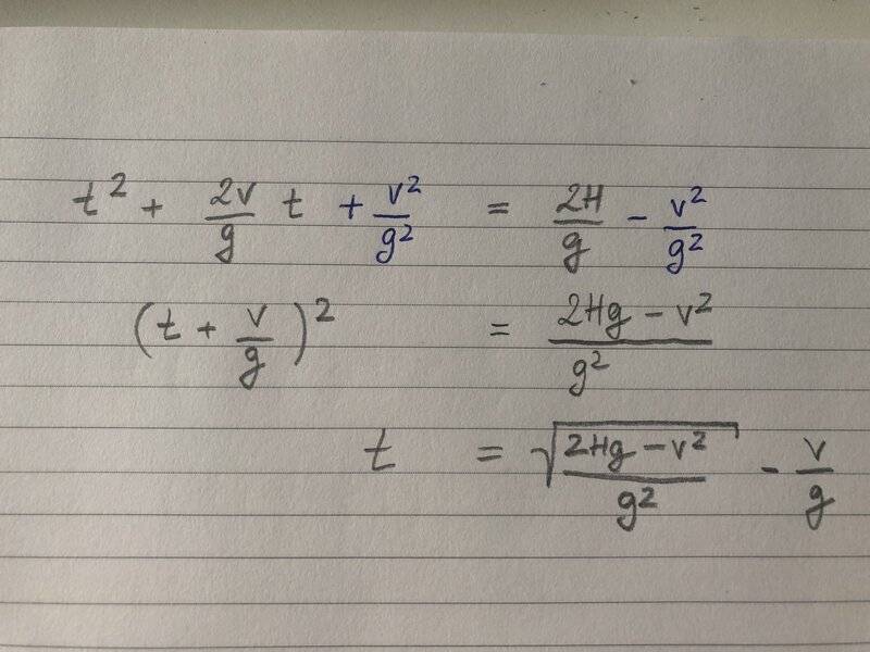

You mean something like this???
Please post math using LaTeX. I'll send you a PM to help you get up to speed on LaTeX.
Likes erobz
It's "like that", but you've made some mistake. You've added ##\frac{v^2}{g^2}## to one side of the equation and subtracted it from the other?
