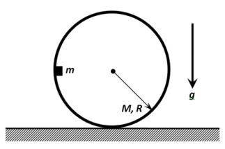

A small puck of mass m is carefully placed onto the inner surface of the thin hollow thin cylinder of mass M and of radius R.
Initially, the cylinder rests on the horizontal plane and the puck is located at the height R above the plane as shown in the figure.
Find the interaction force between the puck and the cylinder at the moment when the puck passes the lowest point of its trajectory.
Assume that the friction between the puck and the inner surface of the cylinder is absent, and the cylinder moves on the plane without slipping. The free fall acceleration is g.

This implies that the point mass just falls straight downwards... not what I expected but I'll roll with it.
vy is zero at the lowest point, so conservation of energy gives:
mgR = 0.5(MV2+I0ω2) = MV2
V2 = mgR/M
If we move to the frame of the cylinder's CoM when the point mass is at the lowest point, then the point mass will be traveling in a circular arc (of radius R) at a speed which is the relative speed of the two objects. Since the point-mass is stationary, the relative speed is just the speed V of the cylinder's CoM. (No need to consider fictitious forces because the x-acceleration is momentarily zero.)
F-mg = mV2/R = m2g/M
F = mg(1+m/M)
This is not right.

This problem looks really nasty. If theta is the angle of the puck's radius below starting point I get ##(m+2M\sec^2(\theta))-m\dot\theta^2= g(2M+m)/R##.
Now, that might not be right in detail, but I think it will be about that nasty. Might need to bring other minds onto the problem.

Since the rotational KE of a rolling, hollow, thin-walled cylinder is equal to the translational energy (so the total KE is double the translational energy), and the cylinder-puck interaction is frictionless, we can solve the problem by replacing the problem with one where the cylinder's mass is doubled and the horizontal surface is frictionless. It's then just like a puck sliding down a sloping, sliding block, except the block has a curved surface.
With this revised problem, we regain the ability to use conservation of momentum.
Let ##\theta## be the puck's angle below the horizontal, which is initially zero, and let ##x## be the distance of the centre of the cylinder from its initial position.
Then conservation of energy gives us:
$$mg\sin\theta=\frac{1}{2}(2M)\dot{x}^2+\frac{1}{2}mv^2$$
Where ##v## is the speed of the puck relative to the ground. This is obtained by vector-adding its velocity ##\dot{\theta}R## relative to the cylinder to the velocity ##\dot{x}## of the cylinder. From a diagram and the cosine rule this is:
$$v^2=\dot{x}^2+(\dot{\theta}R)^2-2\dot{x}\dot{\theta}R\cos(90-\theta)=\dot{x}^2+(\dot{\theta}R)^2-2\dot{x}\dot{\theta}R\sin\theta$$
So the conservation of energy equation is
$$mg\sin\theta=\frac{1}{2}(2M+m)\dot{x}^2+\frac{1}{2}m(\dot{\theta}R)^2-m\dot{x}\dot{\theta}R\sin\theta$$
Momentum is conserved in the horizontal direction, as follows:
$$(2M)\dot{x}+m(\dot{x}-(\dot{\theta}R)\sin\theta)=0$$
where the second term inside the bracket is the horizontal component of the puck's motion relative to the cylinder.
That is:
$$\dot{x}=\frac{m\dot{\theta}R\sin\theta}{2M+m}$$
Substituting for ##\dot{x}## into the energy equation we get:
\begin{align*}mg\sin\theta&=\frac{1}{2}(2M+m)(\frac{m\dot{\theta}R\sin\theta}{2M+m})^2+\frac{1}{2}m(\dot{\theta}R)^2-\frac{m\dot{\theta}R\sin\theta}{2M+m}m\dot{\theta}R\sin\theta\\
&=\frac{1}{2}mR^2\dot{\theta}^2-\frac{1}{2}(\dot{\theta}\sin\theta)^2\frac{(mR)^2}{2M+m}
\end{align*}
This is an ODE of the form
$$a\sin\theta=b\dot{\theta}^2-c(\dot{\theta}\sin\theta)^2$$
I don't know if it can be solved analytically. If not, it could be solved numerically, given values of ##R,M,m##, and then ##\dot{x}## can be calculated by the equation higher up.

I am getting ##F = mg(1+\frac{4M^2+2mM+m^2}{M(2M+m)})##
The only way I see to simplify it is to this: ##F = mg(3+\frac{m^2}{M(2M+m)})##
Using energy conservation, what did you get for v and V?
##v^2=\frac{4MgR}{2M+m}##
##V^2=\frac{m^2gR}{M(2M+m)}##
I got it now, sorry TSny for making you do the dirty work :\
It was a simple algebra mistake (I forgot a factor of 2 on the -vV term in (v-V)2) sorry :redface: and thank you
OK. Interesting problem.
TSny said:
It is justified. That is, the net torque on the cylinder taken about the CoM of the cylinder is equal to IcαI_c \alpha even if the CoM is accelerating.
You're right - I'm cautious about this because I know it can lead to errors in assessing angular momentum.
To demonstrate that it also works taking moments about point of contact:
Let the puck be at ##\theta## below horizontal, and N be the normal force between puck and cylinder.
##R\alpha=A##
##\tau = NR\cos(\theta) = 2MR^2\alpha=2MRA##
Horizontal component of puck's acceleration=##N\cos(\theta)/m=A\frac{2M}m##.
Since the horizontal accelerations have a constant ratio and both initial velocities are zero, the horizontal velocities are also in that ratio.
Let the horizontal velocities when the puck is at ground level be v, V for m, M respectively, measured in opposite directions.
##v=V\frac{2M}m##
##mgR=\frac 12(mv^2+2MV^2)##
Relative velocity = ##v+V##.
Centripetal acceleration = ##\frac{(v+V)^2}R = g(2+\frac mM)##.
Normal force = ##mg(3+\frac mM)##.
Is that the result you got?
Haruspex , could you please explain to me why we take relative velocity for centripetal acceleration ?
Consider the point of the cylinder in contact with the ground. Even though it has no horizontal velocity it does have upward acceleration (##\frac {V^2}R##). So we can see that the speed of the cylinder will affect the acceleration of the puck.
We can take the cylinder's centre as a frame of reference. The cylinder's acceleration is always horizontal, so won't affect vertical forces (and at the time of interest, even that is zero). In this frame, the puck is traveling around a fixed circle radius R at speed v+V.
Likes Qwertywerty
So is this what happens ? - In the ground frame , the acceleration of the bottom part of the cylinder causes change in the radius of curvature , and so we shift to the Com frame .
Is it possible to calculate the radius of curvature in the ground frame ?
Thanks .
If my argument is correct, we can calculate it from ##\frac{(v+V)^2}R=\frac{v^2}{R'}##.
Feel free to try deriving it directly from geometry.
Likes Qwertywerty
  • #31
Yessir
Your method also uses an accelerating axis of rotation. I must say I'm a bit confused about when it is invalid to use accelerating axes of rotation.
Maybe it could be a topic for one of your insights-posts.
  • #32
As I wrote in post #26, I withdraw my earlier objection to using such a frame for torque. The dangers of using an accelerating reference axis for using conservation of angular momentum is covered by one of my Insights posts (Moments).
  • #33
Okay, I didn't know you already covered it, I just knew you posted a lot about misconceptions and common tricky situations.
So torque is fine but cons.of angular momentum is not; that makes more sense, thanks!
  • #34
The basic rotational dynamical law is net torque equals rate of change of angular momentum ##\vec{\tau}_{net} = d\vec{L}/dt##. This law is not generally valid if you take your origin to be a point that is accelerating relative to an inertial frame.
Taking torques about the point of contact, P, between the cylinder and floor can be ambiguous.
For example, you can think of this point as a fixed point of the floor that happens to coincide instantaneously with the point of contact. In this case, P is a fixed point in an inertial frame. Then, the net torque acting on the cylinder about P will equal the rate of change of angular momentum of the cylinder with respect to P.
However, if you consider point P as moving with the point of contact so that P is always underneath the center of the cylinder, then P is now a point that is generally accelerating relative to an inertial frame. Now it will not be true in general that the net torque about P will equal the rate of change of angular momentum about P. For example the rate of change of angular momentum of the cylinder relative to P would not be ##2MR^2 \alpha## (it would be ##MR^2 \alpha##). Setting up ##\vec{\tau}_{net} = d\vec{L}/dt## would lead to an incorrect answer.
As a trivial example consider a point particle falling freely as shown below. Let P be a fixed point in the inertial frame of the Earth that happens to be located at the same height as the particle at the time of interest. Then you can easily check that the torque due to gravity about P equals the rate of change of angular momentum of the particle about P.
Now let P accelerate with the particle so that P is always a distance d to the right of the particle. The torque about P is the same as before. But the particle always has zero angular momentum relative to P. So, relative to the accelerating point P, ##\vec{\tau}_{net} \neq d\vec{L}/dt##.
