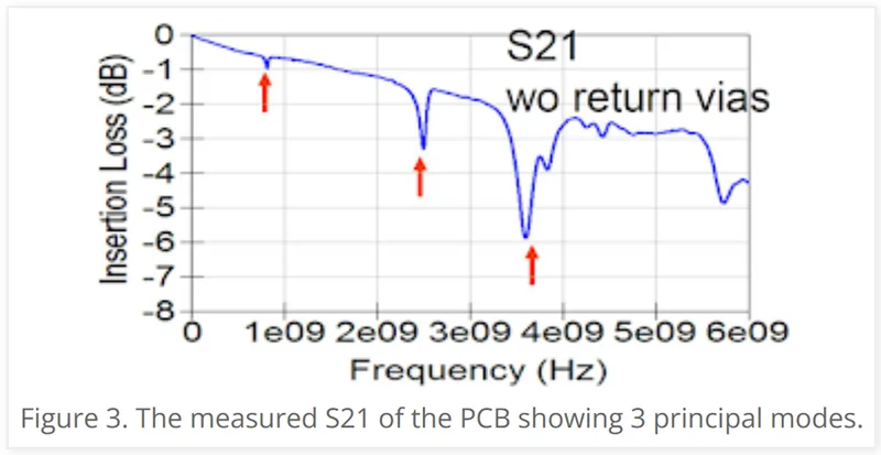

Let's look at a real-world example consisting of a resonant printed circuit board (PCB) structure driven by coax connectors: https://blog.teledynelecroy.com/2020/05/reading-s-parameters-sharp-dips.html. The swept-frequency insertion-loss through the PCB cavity is found to be:
As you note, the observed resonances are (inverse) lorentzian curves, but below the lowest resonance the loss looks nothing like a lorentzian. The loss simply increases slowly but steadily with increasing frequency. So I don't think your "naive" estimates are likely to be valid.

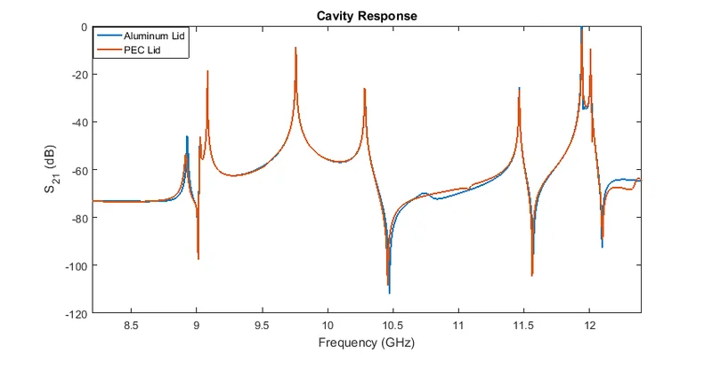

The PCB cavity looks like a through at DC so when driven by coax it transmits 100% of the DC signal. But a hollow cavity coupled with loop- or probe-antennas looks like a short and, as you say, it should transmit 0% at DC. But as the frequency increases from DC, will it necessarily simply follow the tail of the first resonance? Based on this cavity simulation from https://www.researchgate.net/figure/Simulated-S21-response-of-resonant-cavity_fig102_336278497, the low frequency response of a cavity could possibly just "flat-line"/plateau at a non-zero constant value at low frequency:
A waveguide does not follow the shape of the ordinary resonant curve, because it has sharp cut-off on the low frequency side. The PCB example seems to be a TEM line and is not therefore a waveguide.
