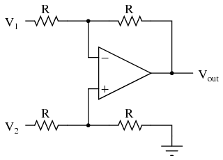

Insert a difference amplifier after the photodetector:
Connect V2 to the +5V supply and V1 to the photodetector output. The value of R depends on the choice of Op-Amp, but I would recommend something around 0.1 -1MΩ.

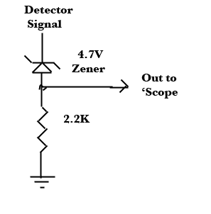

How about this? Depending in the DC level from the detector, you may want the Zener to be 3.3V. The 2.2k resistor value is just a starting suggestion, the actual value depends on the maximum available output current of the detector and the leakage current of the Zener.
Cheers,
Tom
