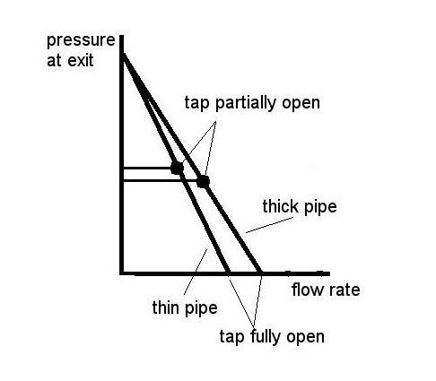

In summary, the old plumber believes that using a smaller diameter pipe will result in a higher pressure due to the increased speed of the flow at the exit. However, this is only true if there are no restrictions on the end of the pipe. In reality, the pressure drop will be higher in a smaller pipe, resulting in a lower pressure at the exit. The old plumber's belief may be due to a misunderstanding of fluid dynamics and pressure measurement methods.
Jonathan212
198
An old plumber who installed 20-30 meters of 1/2'' piping said this size would give a HIGHER pressure compared to the 3/4'' option. Why might he think so?
This is general for all houses in his opinion, please forget my electric heater in this thread.
That depends on where the pipes are and where you measure pressure. A smaller diameter will lead to a higher pressure drop in the pipe section for the same flow.

For another question, not the present one, I have an idea for measuring pressure without a manometer and would appreciate some feedback on it. A long hose going upwards to the height where flow stops (probably 30 or 40 meters), would effectively measure static pressure at the tap. Given this result, can dynamic pressure be calculated from flow measurements? Ie you measure flow without a hose, with the hose going to the same floor, with the hose going to the next floor up, with the hose going 2 floors up and so on. Will this work if the hose cannot go high enough to zero the flow?
Maybe this is plausible. Thin pipe, higher exit pressure. Maybe when the input pressure does not have a flat enough characteristic.

Does anyone have a copy of that book to tell us the parameters for 1/2'' and 3/4'' copper pipe? Should be like this:
output pressure = input pressure - A * flow rate * length
Or does anyone know what to search for in google to get the A value?
1/2'' pipe:
Po(1/2'') = Pi - A * f(1/2'') * L
3/4'' pipe:
Po(3/4'') = Pi - B * f(3/4'') * L
partially closed tap at the end of 1/2'' pipe:
0 = Po(1/2'') - C * f(1/2'') * l
partially closed tap at the end of 3/4'' pipe:
0 = Po(3/4'') - C * f(3/4'') * l
4 unknowns: Po(1/2''), Po(3/4''), f(1/2''), f(3/4'').
For the plumber to be right, Po(1/2'') > Po(3/4'').
=> f(3/4'') / f(1/2'') > A / B
Also
0 = Pi - A * f(1/2'') * L - C * f(1/2'') * l
( A * L + C * l ) * f(1/2'') = Pi
( B * L + C * l ) * f(3/4'') = Pi
f(3/4'') / f(1/2'') = ( A * L + C * l ) / ( B * L + C * l )
hence for the plumber to be right
( A * L + C * l ) / ( B * L + C * l ) > A / B
A * B * L + B * C * l > A * B * L + A * C * l
B * C * l > A * C * l
B > A
So the plumber is always wrong. UNLESS, Pi is not the same for both pipes.

That's different - the same pipe but with a constrained output. In this case the lower flow means less pressure drop along the pipe.
