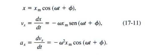

Perhaps that's a very dumb question, but I'm having a hard time to understand why it's possible to omit parts of the equations in solving various problems involving oscillations. Here, for example, the complete equation for acceleration is not used (the part with cosine doesn't appear) and here the complete equation for displacement in damped oscillations (the part with cosine doesn't appear) is also not used.
For the first one, I do not understand where you think a cosine term has been omitted. If you write x(t) in terms of sines and cosines then differentiate twice you get ##\ddot x+\omega^2x=0##, and that is the equation used to solve the problem.
In the second, we are only concerned with a number of whole cycles. In a ratio of displacements at such times, the cosine terms are the same and cancel.

I understood your explanation for the second question, but my physics textbook shows the equation for acceleration with a cosine term (image attached), so I still don't understand why it doesn't appear in the equation used to solve the first question.

There are two ways you can write the same equation
##a=-\omega^2~x##
##a=-\omega^2~x_m\cos(\omega t+\phi)##
Is that what troubles you?

Unless we are talking about a moment when the displacement is maximum and therefore the cosine term is equal to 1, I don't understand how these two equations can be the same
We are in a semantic impasse. When I say the "equation of motion" I mean $$x(t)=A\cos( \omega t+\phi) $$ (with the two constants specified and ##\omega## presumed known). It contains all information about the motion of the particle.
One could report in infinite number of derivatives (v(t), a(t),...) without increasing the information content. Why stop at three? Your book should be clearer about this. Differential calculus immediately supplies the rest.

There is no damping in this problem, so skip the exponential factor in your Relevant Equation. Also, That's an omega (ω), but if you use the letter, w, instead it should be lower case every where.
So you have: x(t) = xmax cos(ωt + ϕ)
and: a(t) = −ω2 xmax cos(ωt + ϕ)
So at any particular time, t, you have that
a(t) = −ω2 x(t) .
It merely a substitution.

There is damping in the second problem I linked. Anyway, I understood your explanation. Thank you very much.
