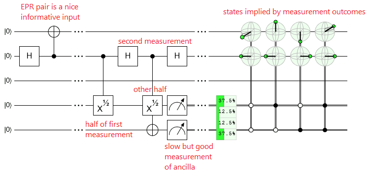

If you're picturing a situation where the measurements take time, then once ##\Delta t## is lower than that time your results will become junk. The specific way in which they become junk depends on how you're doing the measurement. There are many ways to model this, creating many varieties of junk.
For example, suppose we're on a quantum computer that performs up/down measurement by performing a continuous controlled-NOT of the target qubit onto a fresh spare qubit over ##1us## (then it properly measures the spare qubit using some slower process). Furthermore, the computer performs left/right measurement by applying a Hadamard operation arbitrarily fast (rotating the qubit so its old left/right axis is its new up/down axis), then performing an up/down measurement, then rotating the qubit back with another Hadamard.
If we start the up/down measurement at ##t_0## and the left/right measurement at ##t_0 + \text{us}/2## then we are effectively doing half of a CNOT onto an ancilla, Hadamarding, then the other half of the CNOT as well as a full CNOT onto a second ancilla, then Hadamarding, and taking our time to measure the ancilla properly. Like this circuit:
If you pass an upward or downward qubit into this circuit, the qubit ends up leftward or rightward and you don't really learn that the qubit was upward or downward. The circuit does something, but that something certainly isn't violating the HUP. I won't go into the various other behaviors of this particular circuit (I will mention that what's happening the the entangled partner is kinda neat). The main points I wanted to make with it are:
1. You can make explicit models of the "measurements happening so close that they overlap" situation.
2. Those models fail to distinguish between upward and rightward with certainty.
If your measurements are arbitrarily fast, then having them happen near each other isn't different from doing one then the other. If your measurements aren't arbitrarily fast, then they will overlap and generally break each other's effects. The way they break depends on how the measurements are implemented.
