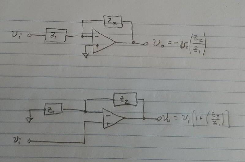

It's great to work this circuit out from basic principles, like you did. But, in the future, you'll want to use a shortcut by memorizing the answer to the simple op-amp configurations below. It will save you a lot of effort later.
Then you can just substitute the complex impedance for Z1 & Z2. This can initially be done just by inspection. My analysis started, with nearly zero effort, like this:
The rest is just a bunch of algebra to make it look the way I wanted (also noticing I'd left out the minus sign, lol).

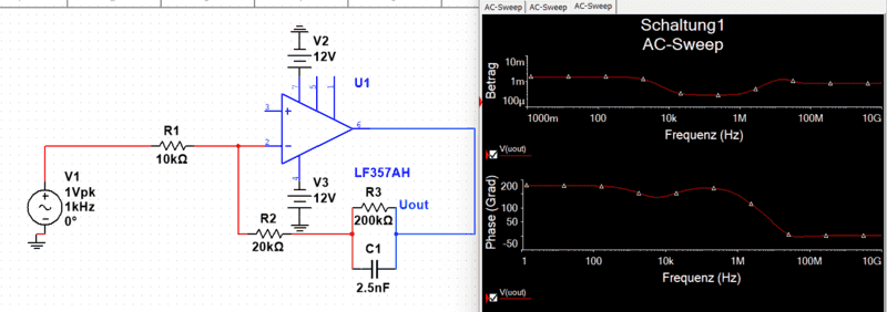

Hello I have one more question. How can I draw the Bode-diagramm?
I simulated in MultiSim it schould probably look like this: Yeah i forgot also to give a logarithmic scale on the upper diagram on Y. On the lower diagram it schould be the phase.
First, you need to connect the + input to your op-amp, to ground, I would suppose.
Drawing bode plots is a bit complicated to explain in a reply like this, but there are several good references on the web if you search for "how to draw a bode plot". You'll want to start by finding the transfer function (gain) in the factored pole-zero form
Likes altruan23
I am a bit surprised about the magnitude diagram - magnitude values in the mV range?
What did you display in this diagram? Vout/Vin ?
More than that - which opamp model did you use? Ideal or real?

Altruan - when you are interested in some help, why didn`t you answer my questions in my post#8?
You have shown a diagram which looks strange - but you did not state what you have shown.
Hello LvW. I am sorry that you were waiting for my reply, i just forgot so that is my mistake. Yeah the diagram is wrong, because i forgot to give a ground to the + terminal of the op amp. Thank you anyways for your help and that you cared and again sorry that i didnt answer your question.
OK - no problem Such things can happen ...if you have some specific questions - do not hesitate to ask again.
