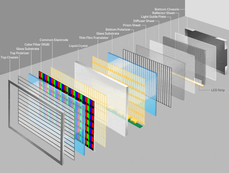

Need help with defining optical qualities of two LCD screen layers that can severely hurt eyes when the screen is disassembled (what do they do to light to make it dangerous)
Hi! I am an electronics engineer and I would be very grateful for some help and suggestions with my problem. I am experiencing severe discomfort when working with almost any LCD screen (smartphones, laptops, monitors). Ophthalmologists say that I am completely healthy and they cannot understand why I experience pressing pain and painful or burning sensation in my eyes. It happens only when I am using an LCD screen. In my daily life I do not experience any slightest discomfort in my eyes. The problem is much more complicated than the most common causes of PWM flickering and blue light. I tested PWM and blue light and they have no impact to my problem. I also have a very old LCD monitor that is safe for me. I can't replace it with any other monitor, as I tried about 50 monitors (both new and old) and all of them hurt my eyes.
I experimented with monitors a lot, and came to the conclusion that the problem is optical. I completely disassembled the LCD screen, took a table lamp with an incandescent light bulb, applied all the screen layers above the lamp one by one, and directed a lamp light onto a white wall. I noticed that my eyes hurt when looking at two layers - a prismatic sheet and a lower glass substrate. Moreover, my eyes hurt even from the reflected light from the wall! The symptoms are exactly the same as when working with the monitor. Does anyone know what these two layers do to light and why it can hurt eyes? I have found many people who have the same problem, to a greater or lesser extent. I have not found any research other than the effect of PWM on flickering and blue light, so any information will be appreciated.

Neither prism sheet nor glass substrate have an ability to flicker, they are just screen layers.
Just wanted to add that under some conditions every person will feel pressure or discomfort or even pain: wearing someone else's glasses, looking at cross-view stereograms, looking at the tip of one's nose etc. It is obviously not a response to a flickering image of one's nose but a normal response to complicated accommodation conditions.
Probably light coming through these layers acquires some qualities that affect vision, focus or accommodation.
Glass substrate is not a simple layer of glass, it is covered by something that bends the laser ray: laser ray looks like big cross and not a small dot after coming through this layer. Prism film turns laser dot into a line.

If you mean parts that are listed on the image at the first post, here is a full story about LCD replacement:
I had another safe monitor, but it is now partially broken and unusable. But I can still see a part of an image on the screen. I purchased a very same monitor model and it turned out to be unsafe. I did it 5 times and all the 5 screens were bad. I learned afterwards that this very device model had 20 different screen panels.
I placed good LCD panel without backlight and backlight unit (so everything from top to bottom polarizer) into a bad monitor and it became safe. It also had no prism layer at the very beginning and all the bad screens had it.
All the bad screens provided slightly different symptoms.

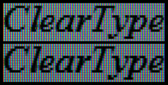

One thing you might try (depending upon what you are running) is to use white lettera on a dark background. Most desktops will offer that as a software switch; I have a friend who is a programmer and we used to use a special moniter cable to invert the stuff. Might help
https://www.eyeinfluence.org/post/d...e7SMbdxrSPCTsexRNDY-XgRDCsGgB0ShoCoMoQAvD_BwE
It seems that colors have little to do with it, I tried that and all the other people also tried. All modern phones have this feature as a software switch, and it doesn't help unfortunately.

Again, I am now more interested in how exactly two non-flickering, very static pieces of material can be so problematic for the eyes.
  • #44
Ok, let me get this straight. Does anyone here have any experience with these layers or knows how they may work? I do realize that everyone are trying hard to help here and I am grateful, but maybe more experience with this particular tech is needed to help with this optical issue.
  • #45
Sure, I can probably dig up some SID papers that discuss those layers (Society for Infomation Display -- the main technical society that deals with this sort of display technology).
informerkh said:
Summary:: Need help with defining optical qualities of two LCD screen layers that can severely hurt eyes when the screen is disassembled (what do they do to light to make it dangerous)
So those two layers are the ones that you can shine DC illumination through and experience eye pain when looking at the light reflected from a white wall?
Likes informerkh
  • #46
Wow! Thank you so much! That would be great! I sincerely hope that will help to figure things out! (At least to define set of non-flicker probable causes)
Yes, they are the prism sheet (it might be not a direct cause of pain in the monitor but it definitely unexplainably hurts when it is disassembled) and lower glass substrate (it has a thin film transistor layer on it and they cannot be separated, at least I could not separate them). Glass substrate might be a direct cause and I can't understand why it has effect so similar to a prism lens.

I also tested another very common source of flicker, Vcom, and there is an opportunity to make it so strong that the flicker will be visible. I had no reaction to it. There are also test images for flickering, and my safe screens were flickering more that bad ones.
For example, this is how severe a Vcom flicker can be (upper image has Vcom flicker captured):
I would rather look at this flicker than to my bad non-flickering screen.
Yes, sure, there may be more than one contributing factor, hope to find them all! :smile:
