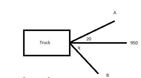

The truck is to be towed using two ropes. If the
resultant force is to be 950 N, directed along the positive x
axis, determine the magnitudes of forces FA and FB acting
on each rope and the angle q of FB so that the magnitude of
FB is a minimum. FA acts at 20° from the x-axis as shown.
I have no idea where to start because there is only 2 known values so i can't use sine law or cosine law. What's the first step ?

Write the equations for the x and y components of the forces FA and FB. Solve for FB in terms of the angle q. At what q is FB minimum?

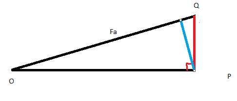

One more question though, there is other method that says in order for Fb to be minimum it must perpendicular to Fa ? Can you explain why it works ?
I don't think it is true. It must be an other problem. What did you get for q? Are FA and FB perpendicular ?

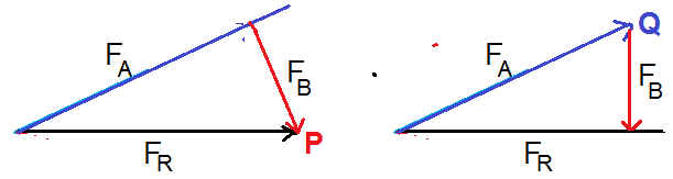

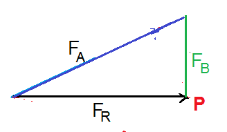

For FB perpendicular FA,is there an explanation for this ? why it works ? and why not perpendicular to FR ?
Sorry if i ask a lot of questions :)
