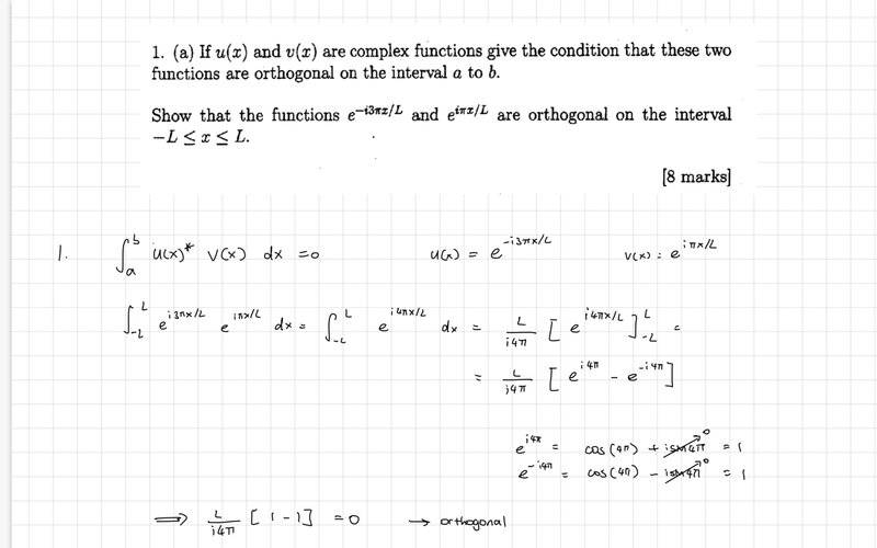

For 2 complex functions, to find the orthogonality, one of the function has to be in complex conjugate? Because in the lecture note, the first formula is without complex conjugate, so I’m a bit confused

The inner product of two complex things always involves the complex conjugate of one of the things. In this case:$$\langle u, v \rangle = \int_a^b u(x)^*v(x) \ dx$$There are loads of hits on Goggle if you search for "complex inner product".

so this condition always applies and the integral always equates to 0 when asking for orthogonality?

That's the definition of orthogonality. It's a generalization of the concept of orthogonality for 2D or 3D vectors. Vectors (or functions) are orthogonal if $$\langle u, v \rangle = 0$$In this case that means that two functions are orthogonal if$$\int_a^b u(x)^*v(x) \ dx = 0$$

so my working out of the question attached is correct?

Looks fine to me.
