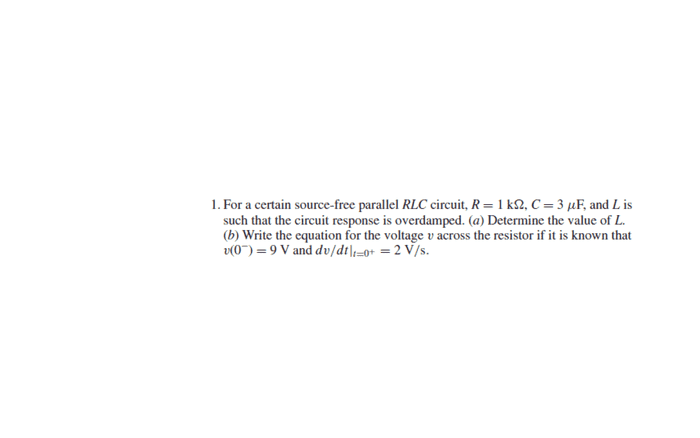

Is this a faulty question? I don't believe that there is one value of L that would make the circuit overdamped.
Yes. It's most likely your teacher copied an old problem and changed critically damped to overdamped to change things up.
