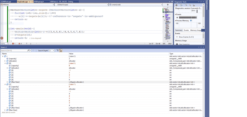

C++:
vector<OP> negate (vector<OP> a) {
    a.insert(a.begin(), neg);
    return a;
vector<vector<OP>> negate (vector<vector<OP>> a) {
    for (int i=0; i<a.size(); i++)
        a[i] = negate(a[i]); // reference to 'negate' is ambiguous?
    return a;
OP is an enum here. Why can't C++ distinguish between these two? One function takes a two-dimensional vector of OP whereas the other one takes a three-dimensional vector of OP. I can't flatten that 3D vector because it's elements aren't of the same size.

C++:
#include <iostream>
#include<vector>
using namespace std;
vector<int> negate (vector<int> a) {
    a.insert(a.begin(), -1);
    return a;
vector<vector<int>> negate (vector<vector<int>> a) {
    return a;
int main() {
    vector<vector<int>> r = {{3,4,5,6},{4,4,5,6,7,4}};
    r=negate(r);
    return 0;
I provided a more complete and simpler code. In line 12 the compilers (Dev, Visual Studio and several online C++ compilers), they're all find that "ambiguous". But since a is of type <vector<vector<int>> then a must be of type vector<int>, right? Negate function adds a -1 value at the beginning of every vector.

It's a complete code. Try pasting the code from my last post into https://www.onlinegdb.com/online_c++_compiler or any other IDE and the error comes out the same every time "main.cpp:12:16: error: reference to ‘negate’ is ambiguous".
There is also a std::negate, which is probably found via argument dependent lookup? Try replacing the "using namespace std" by "using std::vector".
Likes Pete5876
I'm using MS Visual Studio 2022.
BTW, whatever compiler version onlinegdb uses, it also compiles if you don't include iostream. I think the lessons here are 1) avoid "using namespace std;" and 2) don't include what you don't use.

It depends on how the standard library implementers organize their header files. gcc apparently declares std::negate in a header used by std::string, which is included via iostream. You can get this information from the compiler output on onlinegdb:
main.cpp:19:7: error: reference to ‘negate’ is ambiguous
19 | r=negate(r);
In file included from /usr/include/c++/11/string:48,
from /usr/include/c++/11/bits/locale_classes.h:40,
from /usr/include/c++/11/bits/ios_base.h:41,
from /usr/include/c++/11/ios:42,
from /usr/include/c++/11/ostream:38,
from /usr/include/c++/11/iostream:39,
from main.cpp:2:
The latest gcc version also pulls std::negate in together with the vector header. (It can also depend on the language standard used.) So, other than renaming "negate" there is no way around removing the using directive in this example, in which it is also completely unnecessary.
EDIT:
I just realized that std::negate is a struct not a function. Also it can be found by ordinary name lookup, since the unqualified name is already visible thanks to the using directive. At any rate, ADL has nothing to do with it.
