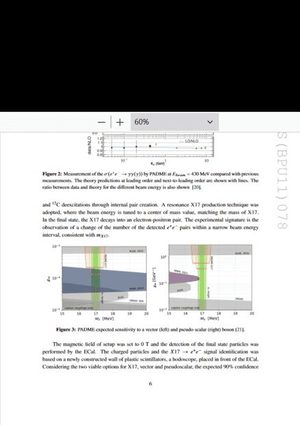

measurements. The theory predictions at leading order and next-to-leading order are shown with lines. The
ratio between data and theory for the different beam energy is also shown [20].
and 12C deexcitations through internal pair creation. A resonance X17 production technique was
adopted, where the beam energy is tuned to a center of mass value, matching the mass of X17.
In the final state, the X17 decays into an electron-positron pair. The experimental signature is the
observation of a change of the number of the detected 𝑒+𝑒− pairs within a narrow beam energy
interval, consistent with 𝑚𝑋17.
Figure 3: PADME expected sensitivity to a vector (left) and pseudo-scalar (right) boson [21].
The magnetic field of setup was set to 0 T and the detection of the final state particles was
performed by the ECal. The charged particles and the 𝑋17 → 𝑒+𝑒− signal identification was
based on a newly constructed wall of plastic scintillators,
a hodoscope, placed in front of the ECal.
Considering the two viable options for X17, vector and pseudoscalar, the expected 90% confidence"

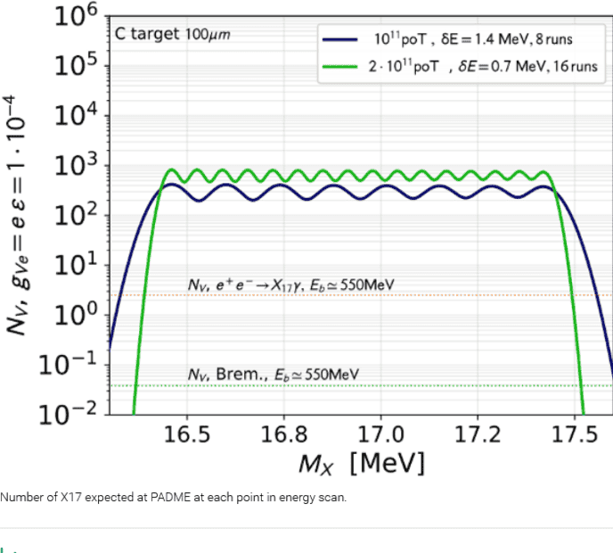

Screenshot 2023-10-05 at 22-01-10 Figure 6 Number of X17 expected at PADME at each point in en...png

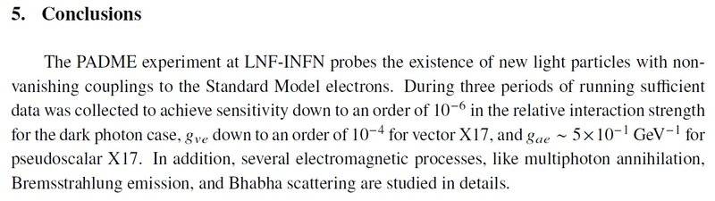

5. Conclusions
The PADME experiment at LNF-INFN probes the existence of new light particles with non-
vanishing couplings to the Standard Model electrons. During three periods of running sufficient
data was collected to achieve sensitivity down to an order of 10−6 in the relative interaction strength
for the dark photon case, 𝑔𝑣𝑒 down to an order of 10−4 for vector X17, and 𝑔𝑎𝑒 ∼ 5×10−1 GeV−1 for
pseudoscalar X17. In addition, several electromagnetic processes, like multiphoton annihilation,
Bremsstrahlung emission, and Bhabha scattering are studied in details
the conclusion says the data allows for "
𝑔𝑣𝑒 down to an order of 10−4 for vector X17, and 𝑔𝑎𝑒 ∼ 5×10−1 GeV−1 for pseudoscalar X17. I"

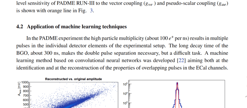

what does
Application of machine learning techniques
In the PADME experiment the high particle multiplicity (about 100 𝑒+ per ns) results in multiple
pulses in the individual detector elements of the experimental setup. The long decay time of the
BGO, about 300 ns, makes the double pulse separation necessary, but a difficult task. A machine
learning method based on convolutional neural networks was developed [22] aiming both at the
identification and at the reconstruction of the properties of overlapping pulses in the ECal channels"

For clarity, I've gathered together the conclusions of the two PADME papers you cited.

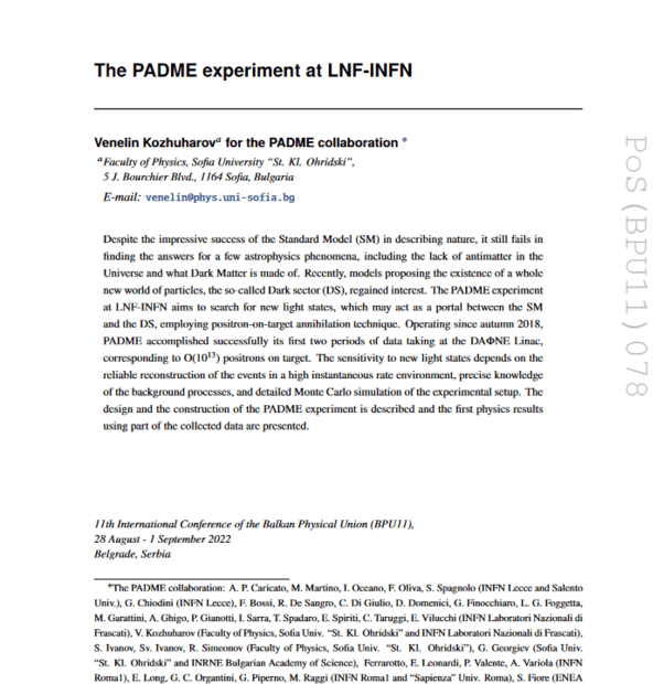

Older: Your "Oct 2, 2023" paper https://pos.sissa.it/427/078/pdf is from a conference that took place in August 2022:
Newer: arXiv:2305.08684 (dated May 15, 2023):
These conclusions simply state that the tested sensitivity and background of the PADME experiment render it suitable for dark photon searches.
But there is no claim that any new particles have been detected.
If the PADME collaboration had any evidence of seeing dark photons, it would have been clearly stated (indeed, shouted!) as such in the conclusions.
