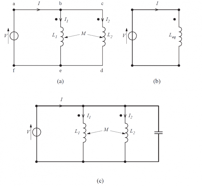

FIGURE 4(a) shows two inductances connected in parallel across an a.c. supply.
(a) Apply Kirchhoff’s voltage law to loop abef and to loop abcdef of the circuit.
(b) Hence or otherwise obtain the current ratio I1/I2 in terms of the circuit inductances.
(c) See if you can show that L1 and L2 can be replaced by the
equivalent inductor, Leq, of FIGURE 4(b) where Leq = (L1*L2-M^2)/(L1+L2-2*M)
(d) A 1 nF capacitor is placed across the two inductors (FIGURE 4 (c)). If L1 = L2 = L and k = 0.5, determine the required value of L if the minimum current I flows from the supply when it is at a frequency of 1 MHz.
(a) ABEF : V=jw*L1*I1+jw*M*I2, ABCDEF : V=jw*L2*I2+jw*M*I1
(b) I1= (V*(L2-M)) / (jw*(L1*L2-M^2)) , I2=(V*(L1-M)) / (jw*(L1*L2-M^2))
I1/I2= (((V*(L2-M)) / (jw*(L1*L2-M^2))) / (((V*(L1-M)) / (jw*(L1*L2-M^2)))
I1/I2 =L2-M / L1-M
(c) Leq = I1+I2 , = (((V*(L2-M)) / (jw*(L1*L2-M^2))) + (((V*(L1-M)) / (jw*(L1*L2-M^2)))
=(V*(L1+L2-2M))/(jw*(L1*L2-M^2)) = V/jw*Leq, Leq = (L1*L2-M^2)/(L1+L2-2*M)
(d) Xc= 1/(2*pi*f*C) = j159.155 ohms

That should be ##I = I_1 + I_2##, the sum of the currents. Current and inductance are completely different animals.

The inductor and capacitor are in parallel, so it would make sense to view this load as parallel admittances. No current will flow if the total admittance is zero, right? How do admittances in parallel combine? You should be able to easily show that the total admittance is zero at resonance.
A push in the right direction anyone on any of these questions. Can someone explain the origin of why in (c) I1+I2= V/jw*Leq
In general the steady state current through an inductance L due to applied potential V is ##I = V/jωL##. In this problem I1 + I2 is the current total ##I## for the load, and V is the potential across the load. So knowing V and I you can determine an equivalent inductance for the load provided that the current has the same form.
Yt=Y+Y+Y...
wC=j0.006 , Yt=0 , 0= 1/jwL -j0.006, 1/jwL= j0.006 , hence zero admittance
Since current is at a minimum at zero admittance, I can solve for 1 of the inductors since L1=L2=L
1/(2*π*√(L*1*10^-9))=1000000 , L=25.33uH
Admittance is the reciprocal of impedance. Both are complex values. Don't confuse them with their magnitudes (the square root of the sum of the squares of their real and imaginary components).
So for the inductor and capacitor in parallel the total admittance is:
$$Y = \frac{1}{jωL_{eq}} + jωC$$
You're given values for C and ω, so it's a snap to find Leq if Y is zero.
With the net inductance Leq in hand, what's your plan to find the actual inductor value L (where there are two inductors couple by mutual inductance)?

Well, the problem states that L1 = L2. So replace them with a single variable.
Leq = L1 and L2, but L1=L2, so one inductor is = leq/2 which is 25/1= 12.5uH
No, Leq is the inductance value in parallel with the capacitor that you found for minimum current (resonance). You also found an expression for the equivalent inductance for the two mutually coupled inductors. You want to find the values for those two coupled inductors. The problem states that they have the same value, so simplify the equivalent inductance expression accordingly. Use the expression for mutual inductance with the coupling constant k, too.
Ok, simplifying the Lt/Leq equation to one inductor variable I get Lt = (L^2-M^2)/(2L-2M), With mutual inductance equation,simplifying, M= k*L
combining the mutual inductance equation with the Leq/Lt equation (i.e Replacing M in Lt equation with k*L)
I get L = 33.33uH

That looks about right. I'm seeing a slightly higher value, but that could be down to rounding of intermediate values.
Re-calculated with Lt= 25.33*10^6 , I get 33.77uH
Okay, now we agree :)

They want you find an expression for I1/I2, presumably starting with the loop equations that you obtained in part (a).
Hint: Start with the loop equations in the form: V = <stuff>.

You're looking for a ratio of the two unknowns I1 and I2, so you really don't need to solve for particular values of them. Just equate the two (V = V, right?) and simplify. Show your work.
So
jwL1I1 + jwMI2 = jwL2I2 + jwMI1
Solve for I1/I2

Do the usual algebra stuff: Cancel common factors, collect like terms. Put the I1 terms on the left, the I2 terms on the right...
Hi Gneill
I think I was looking at this wrong and over analysing it. I think the initial answer to this (in the beginning of the thread) threw me off.
My result.
I1(L1-M)=I2(L2-M)
I1/I2=L2-M/L1-M

To find the value of Mutual inductance I simplified M=k√(L1+L2) to M=kL as L=L1=L2. This gave me M=1.2665×10-5.
This "L" is not the same as your "L" above. You should probably give them different variable names. You don't have enough information to find a value for M at this point. For that you need to find the actual values of the two inductors that will be used.
Simplify the Leq equation using the given information about L1, L2, and k (k simplifies too!). You should find a simple relationship between the value of the net inductance Leq and the value of the actual inductors.
Then I thought to find the the Leq to use the formula of the previous question Leq=L1L2-M2/L1+L2-2M. I have also seen that when two inductances have the same value Leq=L-M/2. Solving this I get 18.99μF.
I think I'm missing something and I'm not sure what! Any pointing in the right direction would be greatly appreciated.
You're mixing up the required equivalent inductance and the actual inductances in your attempt. You found the required equivalent value just fine using the resonant frequency and the value of C. Now you need to find what value of L = L1 = L2 will result in that equivalent inductance.
I got it. Thank you very much for the help!

two loop equations, two unknowns, therefore you need to solve them simultaneously. Use Wolfram Alpha to check your I1 and I2 equations.

For (b) use the two equations you obtained in (a).

Leq = (L^2 - m^2)/(2L -2m)
Replace m with kL
Leq=(L^2-0.5L^2)/(2L-(2x0.5L)
Leq=(L^2-0.5L^2)/L
Leq=(L-0.5L)
Leq=0.5L
Leq=25.33 microhenrys
25.33 microhenrys = 0.5L
L=50.66 micro-henrys
is this right or have I done it wrong?

M is 0.5L, but you've replaced M2 with 0.5 L2. The 0.5 should not have escaped the squaring!
