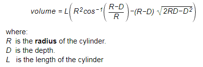

It's been a long time since I've attended school, over 33 years ago. So my question may seem basic to many here. I wish to calculate the partial volume of a cylinder for my excel spreadsheet project. The formula I've found is attached. (unable to type it)
But I do not fully understand this formula. Particulalry the R sq cos -1 section. Could somebody please explain how I use cos
Thank You

Hello, and welcome to MHB! (Wave)
I don't use Excel, but I imagine it would be something like:
Code:
V=L*(R^2*ACOS((R-D)/R)-(R-D)*SQRT(2*R*D-D^2))
Thanks for response. No doesn't work on excel but that's OK, I'll investigate further
