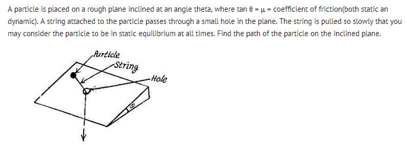

Path of the particle on inclined plane
In summary: Along which directions?In summary, the conversation discusses a problem involving a particle in static equilibrium on an incline, where the angle of the incline is set at a special value such that the particle does not slide down. The conversation also explores the relationship between the angles of the plane and the string, and the equations involved in resolving forces along the length of the string. It is determined that the friction force will act principally up the incline and its magnitude can be represented by the weight of the particle.
Vibhor
971
40
[/B]
Honestly speaking , I have little idea about this problem . All I can think of is that since the particle is in static equilibrium , the particle has no acceleration .
So , if T is the tension in the string then resolving the forces along the length of the string T = μmgcosθ + mgsinθ . I am not sure if this is correct .
Please help me with the problem .
Thanks

There are two angles to consider: the angle of the plane to horizontal and the angle of the string to a horizontal line that lies in the plane. I believe your equation is confusing the two.
Here, it is given that tanθ = μ, which means that the inclination, 'θ', is set such that the particle does not slide down. At the same time, the particle is pulled in so slowly that the particle has a constant velocity. So, I guess, the particle moves radially inward.

No, that does not work. The friction just manages to oppose motion as long as the tendency to motion is directly down the slope and not assisted by the string. As soon as you supply a sideways force, the total force will exceed friction, but the friction now acts to oppose the resultant of the tension and the downslope component of gravity. So the upslope component of friction is no longer sufficient to balance the downslope component of gravity.

Your equation only fits that statement if the string is directly up the slope from mass to hole.
Try this as a first step. Suppose the string is horizontal from mass to hole. With no tension, you have the friction acting up the slope exactly matching the component of friction down the slope. If you pull very gently on the string, the particle accelerates. Suppose it accelerates at an angle φ to the "downslope" line. Which way is friction now acting? What equation can you write for the acceleration?
Maybe use x for the horizontal direction within the plane and y for the upslope direction.

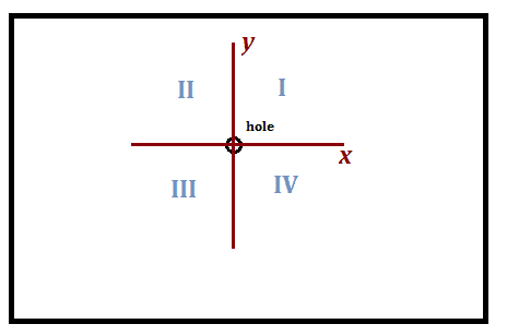

Let me make sure I understand your coordinate system. Origin is at the hole, x-axis horizontal to the right, y-axis upward along the slope. ##\phi## is angle between positive y-axis and string. Not sure if ##\phi## is measure positive in the CW direction or CCW direction. Also, not sure which quadrant you have placed the particle.
A diagram showing your conventions would be nice.
I believe the case where the particle is above the x-axis is different than the case where the particle is below the x axis. So, I suggest treating the cases separately and dealing first with the case where the particle is above the x axis.

Origin is at the hole, x-axis horizontal to the right, y-axis upward along the slope. ##\phi## is angle between positive y-axis and string. ##\phi## is measured positive in the CCW direction. Particle is in second quadrant , I guess (case where the particle is above the x axis)

In which quadrant is the particle?

Second .

I think second quadrant is harder than first quadrant. Go with the easier case first. Think about what's going on with no tension in the string and then imagine what happens as you gradually apply tension.

The picture in OP shows particle to be in second quadrant . Right ?
Yes, sorry! You are right to begin with the second quadrant. Then treat the case in the third quadrant.
