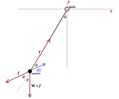

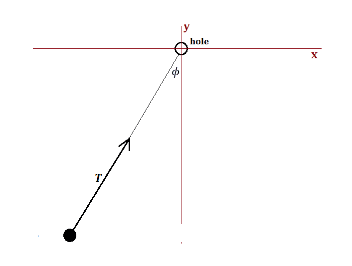

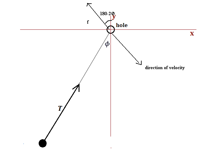

  • #61
TSny said:
The important thing is to find the direction of the friction force just before slipping.
If particle sits at rest in third quadrant i.e when T = 0 , then friction acts up the slope .
TSny said:
If ##\phi## is the angle that the string makes to the (negative) y-axis, try to find the angle between the string and the friction force in terms of ##\phi##.
The angle would be ##\phi## .
TSny said:
Also think about which way the particle is going to move when it slips.
The particle will try to move at an angle ##180° - 2\phi## with the -y axis measured CW .
  • #62
OK, your directions look good. But it seems to me that the arrows you added should be drawn at the particle rather than the hole.
[EDIT: I noticed that you did not draw the direction of ##f## very accurately. Your value of ##180^o - 2\phi## is correct. But if you draw this angle more accurately, I think you will see that ##f## points in a different direction.]
So I think you have the correct angle for the direction of motion of the particle. Let ##r## be the length of the string between the particle and the hole. You want to find the path of the particle. In polar coordinates, this would be ##r## as a function ##\phi##.
Suppose the particle undergoes a small displacement ##ds##. Can you find expressions for ##dr## and ##d\phi## in terms of ##ds##, ##r##, and ##\phi##?
Likes Vibhor

  • #71
So, since you got the angles correct, your diagram hopefully looks something like this:
Likes Vibhor

  • #74
##-dscos\phi = dr ##
##-dssin\phi = rd\phi ##
From this I get ##\frac{dr}{r} = \frac{d\phi}{tan\phi}##
  • #75
Great! The first two equations above can pretty much be read directly off the diagram. But using the unit vectors is good, too.
Likes Vibhor
  • #76
Integrating I get ##r=Csin\phi ## , where ##C## is a constant .
  • #77
Yep.
  • #78
Does that mean distance of the particle from the hole is oscillating (alternately increasing and decreasing ) like a sine curve ?
  • #79
I don't think so.
Perhaps the curve will be more recognizable when expressed in terms of the Cartesian coordinates of the particle (x, y).
Likes Vibhor
