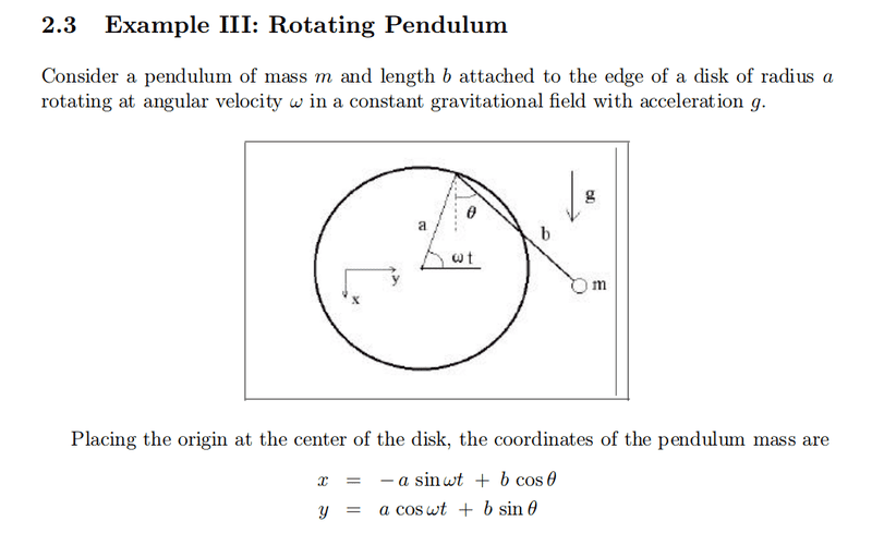

I try to derive coordinates for a mass on a rotating pendulum using a different coordinate system
$$(x,y)$$
For this problem,
I correctly got the same coordinates for the pendulum mass using another coordinate system. The coordinate system I used was the other coordinate system rotated counterclockwise by 90 degrees. Why is the pendulum mass coordinates invariant in my cartesian coordinate system (x̄,ȳ)?
Thanks for any help!
ChiralSuperfields said:
Homework Statement: I try to derive coordinates for a mass on a rotating pendulum using a different coordinate system
Relevant Equations: $$(x,y)$$
For this problem,
Do you mean that your system was x positive to the right and y positive up?
In that system it would be ##x=a\cos(\omega t)+b\sin(\theta)##, ##y=a\sin(\omega t)-b\cos(\theta)##.
  • Love
Likes member 731016
Thank you for your reply @haruspex!
Yes you are correct!
Thanks!
