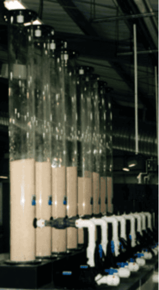

There are also a number of technologies being developed to remove PFAS from the environment, these even include biological control, there are now some 400 organisms identified that can break down plastics.
I have a friend who made a system using micro-organisms to rapidly remove some nasty toxic chemical contaminant from ground water.
The water is pumped out via well and run through a fluidized sand bed
(kind of like this:)
but 10-20 foot diameter and 8-10 feet tall.
The bacteria grows on the sand which is constantly falling through an upwelling flow of contaminated water. It could handle big flows of water and the treated water was clear of the contaminant.
He found the bacteria by collecting mud in industrial areas were the chemical had a history of being spilled.
He made a bunch of money on this because the alternative was run to pumped water through very large charcoal (activated carbon) filters (very expensive). Then the charcoal would have to disposed of in safe way because the chemical was still in the charcoal, not destroyed as the bacteria would do.
These are the same kind of filters used in many large fish facilities (which is how I met him).
