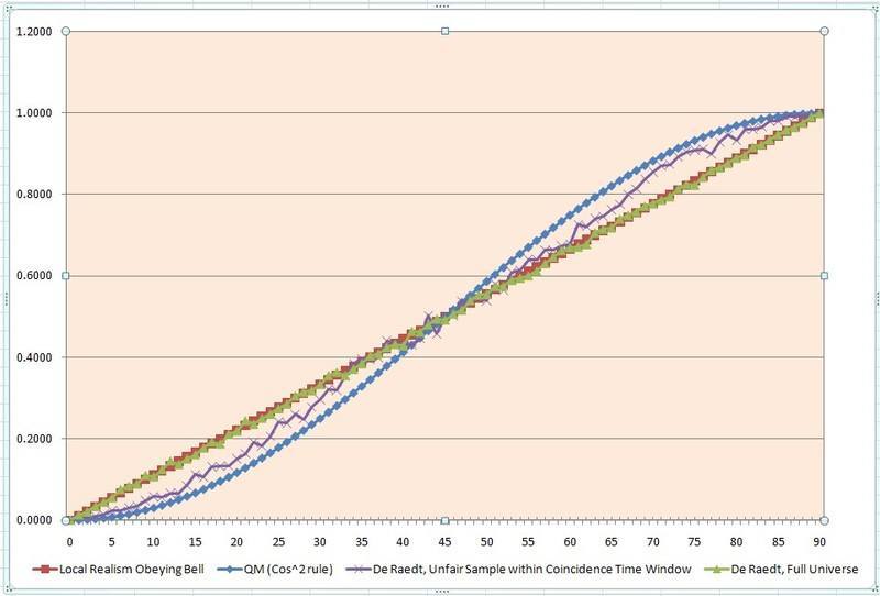

zonde said:
1. If for you QM starts and ends at non-locality then yes, I am challenging QM.
2. About testing with different angles. I am drawing graph using 32 different angles - is it enough?
3. What is the second critical test? Type II PDC? Simple thing - just make a difference of 90 deg. between POL hidden variables of Alice and Bob with PH keeping the same difference as before.
4. But it seems to me that you are not caching the meaning about this fair sampling assumption thing. ... But if fair sampling assumption does not hold there are plenty of possible ways how to construct such models that violate Bell's inequalities and it does not matter if experimental results justify them or not.
Bell's inequalities does not prove anything if fair sampling assumption does not hold. And sorry but this IS mainstream view.
1. I only advocate the position that local hidden variable theories are not tenable. I do not advocate non-locality in particular.
2. 32 is NOT enough. Unless of course you are talking about SIMULTANEOUS values. I want to see 3 *simultaneous* values for angles settings I choose. Preferably either 0/120/240 or 0/45/67.5 as these are the most often used examples. If you can only show 2 at a time, you don't have a LHV theory. Sorta like taking the magician at his word when he says, "nothing up my sleeve"...
3. You haven't explained Type II PDC by saying the crystal is rotated in your formula sheet. For a local realist to explain Type II PDC it will take a lot. The reason is that there is NO 360 degree polarization entanglement from a single crystal. The output of either alone lacks that characteristic! Only when the outputs are superimposed does this feature emerge! If the photons emerged from one or the other but not both (as a local realist would insist), then the entanglement is not explainable.
4. Yes, indeed it is the mainstream view that IF the fair sampling assumption were discovered NOT to hold, then Bell test results might be invalidated. So what? If next week the speed of light were discovered to be 4 kilometers per second then a lot of other science might be invalidated too. Fair sampling is the cornerstone of science, my friend, and has absolutely nothing to do with Bell tests in particular. Obviously, there are some cases in which the data points are relatively few and far between and there may in fact be a natural bias. An example would be celestial objects used as "standard candles". But you can't model a theory (such as a LHV) that runs counter to the data and explain it as "supported" and "consistent".
Do you have some data to share? You saw my requested angle settings. Just show me data for 3 simultaneously and we can get on with the main show here.
But you do not separate whether LHV theories are viewed as as interpretation of QM or as entirely different things?
I suppose you mean that different angles are calculated with the same set of randomly generated HV. Right?
For relative angles 0/45/67.5 and three different angles for Alice (0,45,90) with the same set of HV (65534 rows):
1701/813/227
1654/851/266
1646/805/242
Just to understand the question - do you say that model should explain not only measurement process but generation process at source as well for you to consider the model? If that's so it surely will take some time.
Yes, but there are reasons for that particular cornerstone. You can never test everything so you have to make some assumptions to move forward. You have to disregard some information in favor of other information you want to know.
But it does not mean that assumptions can not be revisited later including fair sampling assumption in some particular context.

zonde said:
1. But you do not separate whether LHV theories are viewed as as interpretation of QM or as entirely different things?
2. I suppose you mean that different angles are calculated with the same set of randomly generated HV. Right?
1701/813/227
1654/851/266
1646/805/242
3. Just to understand the question - do you say that model should explain not only measurement process but generation process at source as well for you to consider the model? If that's so it surely will take some time.
1. I think an LHV will not be an interpretation, it will be a different theory.
2. This needs to be discussed separately because we are getting close to the crux. I believe I understand your numbers as follows:
1701/813/227 means coincidences for 0, 45 and 67.5 degrees (relative to Bob), where Alice is oriented at 0 degrees. Or?
3. My point is that local realists struggle to prove Bell/Aspect wrong, failing to realize that their hypothesis is elsewhere contradicted. That is why the Bell Theorem states that no LHV theory can reproduce ALL of the predictions of quantum theory. Once you understand the full implications of the requirement, it becomes a much larger issue to overcome. That is why Santos, Hess and others have failed, because they have stumbled in postulating a full and consistent LHV hypothesis that actually leads to the predictions of QM.
Explaining Type II PDC is not simple for an LHV theory, so we should take it off the table for now. But that doesn't mean it isn't there.

DrChinese said:
Can you help me decipher this statement:
k2=ceiling(abs(1-c2*c2)**(d/2)*r0/tau) ! delay time
this looks to me like:
k2=ceiling(abs(1-(c2*c2))**((d/2)*(r0/tau))) ! delay time
and since d=2 and static reduces to:
k2=ceiling( abs(1-(c2*c2))**(r0/tau) ) ! delay time
The model produces the expected results when you use only d/2 for the power (exponent):
(1-c22) d/2
and then muliply with r0/tau (I had the same problem, so I used a fortran debugger to check the calculation. Attached a graph of my simulation. Green is when one only assumes Malus for the photons (without timetag))
  • #85
ajw1 said:
The model produces the expected results when you use only d/2 for the power:
(1-c22) d/2
So verifying that we: DO multiply the entire result by r0/tau, and do NOT multiply the exponent d/2 by r0/tau?
Graph looks great by the way.

I have put together a model that generates the attached values when run for the range 0 to 90 degrees, incrementing by 1, and 5000 iteratations for each pair of angles. The coincidence time window is k=30 ns (scaling is by algorithm). This is a good representation of their model for Type II PDC, and follows their formula faithfully.
The purple line shows the sample, which is "close" to the QM predicted values (close being relative - keep in mind that Bell tests do not match the QM predictions perfectly either). This matches what they wanted for their model. The green line shows the full universe plot, which respects the Bell Inequality. This also matches what they wanted for their model. A few points to keep in the back of your mind as the discussion continues:
a. Because their full universe matches the LR boundary condition (so as to obey Bell), it obviously does NOT respect Malus. You can see that on the chart. So that is a nasty little issue to deal with. That is one of the reasons that folks say that no LR theory can agree with ALL of the predictions of QM. I think it has been long realized that this would be a result of any algorithm that could address the entanglement side of things.
b. Also, while it appears from the attached chart that Bell's Inequality is not violated for the full sample... that too is somewhat misleading. My spreadsheet documents the event by event portion in an explicitly realistic fashion. It accomplished this by displaying the results of every iteration for any trial you want to run. It then models what happens if you could test particle 2 at an extra angle setting, 45 degrees offset to the main setting for particle 1. So such simulation shows a total of 3 measurements. Only 2 are physically possible in an actual experiment, but in the computer program 3 are possible while respecting the model. Because the LR boundary condition only works when there are NO events of a certain type, the presence of those events could mean that Bell's Inequality is violated after all. I will have a picture of this shortly in case the reasoning is not clear from my verbage.
c. I should soon have a diagram showing my original objection to their model describing at the beginning of this thread. That being that their model does not handle photon pairs that are not polarization entangled, although they explicitly claim it does. That cannot be seen from this chart.
Result does not seem very good. I think it should fluctuate around QM prediction but it is constantly closer to straight line. Isn't it so?
This can not be seen from graph because reference in the graph is relative polarization angle between two photons and not polarization of individual photons of one side relative to polarizer. The model is silent about that so it can not be judged by that.
Picture might help. But from what I understood there is nothing wrong with LR model if it can demonstrate different angle settings for one side while keeping the other side intact. That just makes the point about element of reality present.

zonde said:
1. Result does not seem very good. I think it should fluctuate around QM prediction but it is constantly closer to straight line. Isn't it so?
2. This can not be seen from graph because reference in the graph is relative polarization angle between two photons and not polarization of individual photons of one side relative to polarizer. The model is silent about that so it can not be judged by that.
3. Picture might help. But from what I understood there is nothing wrong with LR model if it can demonstrate different angle settings for one side while keeping the other side intact. That just makes the point about element of reality present.
1. It's not too bad. Ideally they would have something closer to the QM value. Because they achieve the result by the introduction of a random fluctuation, the amount is about halfway between.
You don't notice the issue on their graphs because they sample only at a few pairs of angle settings. My simulation fills in the gaps by running across 90 degrees by degree. To be fair, I do not consider their presentation in this regard misleading.
2. I don't agree.
3. After finishing the model last night, I checked this element out. It turns out the "suppressed cases" (2 of 8 permutations) worked out fine in their model, so as to not cause an issue.
