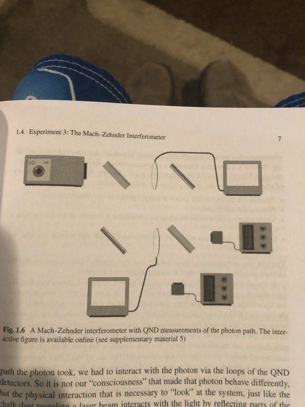

The diagram is the type of interferometer setup I’m dealing with, a beam splitter and a few mirrors in place and a couple of looped QND(quantum non-demolition detectors). With the photon detectors at the ends.
