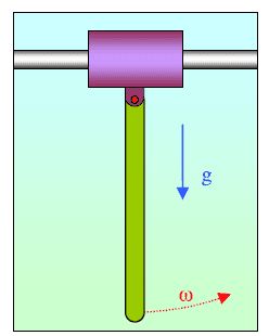

1. Homework Statement
The violet sleeve has mass M and is free to move horizontally without friction. The green rod has mass 2M and length L and can rotate around a pivot on the sleeve without friction. At t=0, the rod is in vertical position and is rotating with angular velocity w. What are the physical quantities that are constant? What is the maximum angular amplitude of oscillations and maximum sleeve speed?
2. The attempt at a solution
K_{tot} + U_{tot} = constant (there aren't dissipative forces such as friction)
Linear momentum: there are external forces (weight force and vincular reaction) so it isn't constant.
Angular momentum: whatever pole I choose there is some external force that have nonzero torque, so it isn't constant.
I tried to solve the problem calculating the torque with respect to the pivot, but the problem is: that pole is in motion, so I don't have
, but I have
(pole velocity isn't parallel to mass center velocity)... and so I can't go on to calculate angular acceleration and I'm stuck.
Could you help me?
Are you familiar with Lagrange mechanics?
What can you say about the horizontal component of the net external force on the system?
@Orodruin: no, I don't know anything about it.
@TSny: There's no net horizontal force, hence the horizontal linear momentum is constant.. but how can I proceed then?
Yes.
Consider the system at the instant θ is a maximum.

I think I've got the idea. But there's a doubt. At theta maximum, the rod has zero angular velocity, but with respect to the pole (so the system is all going with velocity V)... So i can extract from there the maximum sleeve velocity... Am I wrong?
Yes, at max θ the rod has zero angular speed. There is no need to say "with respect to the pole".
And, yes, all points of the rod and sleeve have the same velocity at this instant.

The sleeve does not have its max speed when θ is max. The first question is to find θmax. You know that all points of the system have the same velocity when θ = θmax. See if you can use this fact along with the conservation laws to determine θmax.

@TSny ok I followed your hints and I found cos (thetamax) from the conservation of energy (at t=0 the energy is all rotational at thetamax the energy is gravitational and translational (i can find the speed from the conservation of horizontal linear momentum). Now I can't go on with Max sleeve velocity, at first I supposed it was at thetamax, you pointed out i was wrong.. and I can't guess in which position it is!
Consider what happens after the rod reaches max angle to the right. As the rod begins to swing back down toward a vertical position, what happens to the horizontal momentum of the rod? So what happens to the horizontal momentum of the sleeve as the rod swings back down?

So I have misinterpreted @TSny message. Let's start again. I choose the frame of reference in which total linear momentum is zero when theta is max. And then? I can't see how to "work out the max speed of the sleeve in this frame" !
@TSny "Consider what happens after the rod reaches max angle to the right. As the rod begins to swing back down toward a vertical position,what happens to the horizontal momentum of the rod?" Well, I think that the rod velocity with respect to the pole has decreased up to zero (in theta max) and then it reverse sign and starts to increase again... But this is only with respect to the pole and this fact makes me impossible to get how things are going. Could you please be more explicit? I'm stuck with it and cannot go on.
There is no need to specify "when theta is max". As you have already concluded, the linear momentum is conserved. Think about how you can use this fact to your advantage. What does it mean that the linear momentum is zero?
Edit: Note that both the sleeve and the rod will move in this reference frame!

I think you are saying that it means that the two moments are opposite. So I get the maximum (in absolute value) momentum for the sleeve when the rod momentum is maximum (in absolute value). Is it correct? But in that frame, the rod momentum is maximum when?
Have you tried writing down expressions for the momenta and energy?
well, I am not used to write these expressions in particular frame:
Mv (current sleeve velocity)= 2Mw_cm, where w_cm is w(the current angular velocity)*L/3 (the distance between the pole and the center of mass) .. I equate them because the sum should be 0
E=1/2 M v^2+1/2 I(the moment of inertia)*w^2+2M*g*(L-L*cos theta)

In the original frame of reference, when the rod reaches maximum angle, the rod and sleeve are moving together with some speed V toward the right. As the rod swings downward, what happens to the horizontal component of the velocity, vx, of the center of mass of the rod relative to this frame of reference? Does vx increase, decrease, or stay at the value V?
If it's difficult to see the answer to this question, it is helpful to think about it from the point of view of the reference frame that moves with constant speed to the right such that the total linear momentum of the system is zero. In this frame, think about what the system is doing at max angle of the rod. Then think about what must happen as the rod swings back down.
It should increase because when it swings down some potential energy becomes kinetic... Is it wrong?
Does the swinging down contribute velocity to the right or to the left for the CM of the rod?
Well, I think left, because it goes towards the vertical position... so vx decreases..
Yes. At max height, the rod has some momentum, px, to the right (relative to the original reference frame). As it swings down, the velocity of the CM picks up some contribution to the left due to the rotational motion. That is, there is a change in velocity of the CM of the rod toward the left. So, taking x to be positive toward the right, does px for the rod increase or decrease as it swings down?

I think that the rod momentum decreases while the sleeve momentum increases, because the horizontal momentum must be constant...

Is it that the maximum sleeve velocity is when the rod has come back in the vertical position?
Here's where the zero-momentum reference frame is useful. The animation you posted earlier is similar to being in the zero-momentum frame. What is the orientation of the rod when the sleeve has maximum speed?
