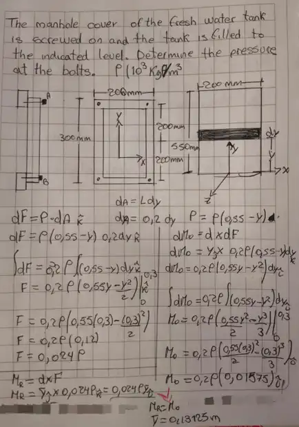

Vale Tum
The manhole cover of the fresh water tank is screwed on and the tank is filled to the indicated level. Determine the pressure at the bolts.
dF=P*dA ; H=550mm ; Varignon's Theorem
I did some of the exercise, but I don't know how to apply the momentum :'(
Likes einsteinsteve
Can you explain this some more. The lid is put on the tank (making a seal). The tank is initially filled with air, then water is pumped in, trapping a pocket of air between the water surface and the lid. Is that the scenario?
Or looking at your solution attempt a bit more, it looks like a fluid statics problem where you find the force acting at the center of pressure on the plate. Either way, I think you need clearer diagramming of where/how this plate is oriented on the tank.
Not sure I understand the diagrams. Pls supply the full description of the problem and state your coordinate system.
I think that's what's happening. The air is compressed, so the solution is to find the change in pressure given the corresponding change in volume.
