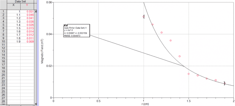

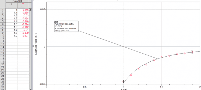

An ideal solenoid is expected to generate a dipole field that falls off quickly as you move away from the solenoid. The magnetic field at distance r along the axis of the solenoid is given by B = (Mo/ 2pie) (M/r^3) In this equation the parameter M is called the dipole moment and it is equal to M = NIA where N is the number of turns, and A
the cross-sectional area of the solenoid.
Calculate the value of the M , knowing that the number of turns in the solenoid you have is 1080 and the corss-sectional diameter is about 7.5 mm. Enter your measurements from the table above into the Logger Pro program and plot B vs r for each side of the solenoid. Then, perform a “variable power” fit of the form Y=AX^n with n set to -3 and identify the value of of the fit parameter A
Using the data you now have determine the value of the permeability of free space MoBe careful with the units

fit parameter A = 0.7090
WHERE does the new A be placed ^?
From your equations for B and Y, you can see that A_fit = M_0 * M / (2*pi). You are supposed to find a value for M0.
It seems that the instructions are telling you to set the gradient of the power fit graph to the suggested value for A in Logger Pro.

Yes I understand that, which I did. I found the Value for A with the new equation Y=Ax^-3 ...I just don't understand why I need that A when they gave me an A already for the formula..
Maybe they first want you to verify the power -3 with the supplied A
and then fit again with the power to obtain an experimental value for A?

did you get the A (= 0.7090) fit parameter from logger pro by inserting n = -3?
yes

Isn't the magnetic field just the recording of the magnetic sensor as i move it away in 1mm increments from the solenoid?
Just make sure that my calculated values for B* is correct. One would think so yes, but there is quite a difference between the measured and the expected values - B*, so something is seriously wrong with the experiment, the apparatus, the procedure or ...? Plus the datapoints do not really conform to a straight line graph.
I only notice it now, but you were suppose to measure the field outside one end of the solenoid as you move further and further away. Since the coil is so small I assume that is what you did? The question then arises how one is suppose the measure r, form the end or ...? The formula suggests that at r = 0 one gets an unrealistically large magnetic field? Do you know what the length of the solenoid is?

How did you get the numbers for B*(T) ... I just re did the lab again and got different numbers. this is my graph with the fit...https://attachment.outlook.office.net/owa/ChadNiddery@hotmail.com/service.svc/s/GetFileAttachment?id=AQMkADAwATYwMAItYTJhMy05YjY4LTAwAi0wMAoARgAAA1%2BGrg4JVahNrFK%2BtBRQxHMHABLpo8Xq25xEnBcsyMWzy8YAAAIBDAAAABLpo8Xq25xEnBcsyMWzy8YAAABJcj45AAAAARIAEADCm1IHbFWERrKKATpfIEQP&isImagePreview=True&X-OWA-CANARY=MExmzr-Mc0SI8-cmfdNr6lBhb1Ua_9IYsqRCrXT1KBke2gOlwMc_Hyqk1XEIOO0im2agejgNszg.&token=ab71b942-38cf-4b84-98f8-6722154f1278
  • #35
the magnetic field recorded i converted to Tesla from mT, and converted the mm, to m
