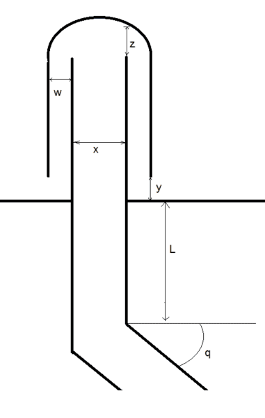

I'm trying to build a home aquaponics system, and a key component of the design I got off the internet is a bell siphon. So I'm trying to understand the physics of this siphon effect so I can optimize the weight and dimensions of the siphon to fit the size of my system.From what I read on the internet, the siphon works as follows:
- When the water first gets sucked down the vertical standpipe, it sucks some air down the tube and thus leaves a bit of a vacuum in the top of the bell. This will encourage more water to flow into the bell and down the tube.
- When the water level in the tank gets low enough, outside air is sucked into the bell and breaks that low pressure zone.
Is that correct?
Also, are there some equations I can use to see what effect changing the geometry of the siphon components will have? Higher elevation from tank bottom, larger ID on the bell, larger ID on the standpipe, taller bell, etc. Or even using some kind of tapered design?Thanks!
The second diagram appears to be wrong. Due to reduced air pressure, the water level inside the bell will be higher than the water level outside the bell. The image should show the water level at or above the drain pipe opening, not being pulled up as a stream into the drain pipe.

Apparently the physics of a bell siphon are pretty complicated, but do you think you can help me derive a few equations to explain the impact of changing certain dimensions? Or even just an intuitive explanation if the equations are far too complex.
Thanks!https://www.physicsforums.com/attachments/212164
All the designs I have seen have a long tube out of the bottom and many have a 45 degree bend. X should not be too great as you need the initial overflowing water to block air from coming up. You need to reduce the air pressure in the invert space.

As far as I can see, the basic requirements for operation are
1. The down pipe is narrow / long enough to block air from entering that way.
2. The inlet flow is less than the outlet flow when the reservoir level is at the bottom.
1 seems to be easy enough to achieve with a long down pipe. I also read about putting a small constriction near the top in it to hold back the initial falling water to form a slight plug or a small U section on the down pipe.
As the tank fills the water level will eventually reach the top of the inner tube and spill over the top. What happens next?
To begin with the water rate down the inner tube will match the fill rate of the tank. However if the water flowing down the inner tube succeeds in dragging a little air along with it then the water level inside the dome will rise as the air cap in the dome shrinks. A rise in the water level spills more water down the inner tube which carries more air until the inner tube is completely full of water and the siphon is flowing at its maximum rate.
However, if the water does not succeed in dragging any air down the inner tube then there is no siphon!
How do you fix this?
  1. Increase the flow rate filling the tank.
  2. Increase the water velocity running down the inner tube by;
  • reducing the pipe size,
  • keeping the pipe vertical (maximum gravitational axis for the water)
  • lengthening the pipe (more time for water and air interaction)
  • adding a flare on the top of the inner tube (does this give a bigger surge to the initial water flow rate down the pipe as the meniscus in the annulus breaks?)
Interactions between water and air in pipes have been extensively modeled as it is a reasonable analog for commingled gas and oil production in the oil industry. However in the case of downward flow in a siphon the situation is less studied. The one paper I found by Dukler suggests that the water will flow in an annular film down the inner wall of the inner tube (doing its best to ignore the air) until a superficial velocity of around 0.5 m/s is achieved. Using a ball park figure of 0.05 for the water void fraction that means annular flow will be happy up to a water wall velocity circa. 10 m/s.
The challenge therefore is to maximise the water velocity while at the same time trying to mix the water with the air without killing too much of the water velocity. I suspect that some nails through the inner tube and and angled downwards may do this.
Thank you for letting me clarify my thoughts by drafting this piece.
