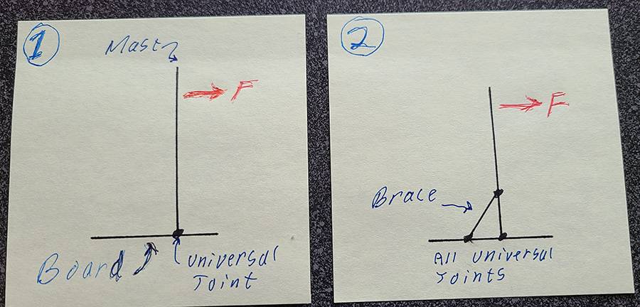

[separate post]
Does any member agree with me about this what I just explain in this post?
@John Mcrain you need to start doing better, because at this point we are starting to doubt your sincerity. You are stating false things and misrepresenting what people are telling you. The key issue is so simple it is difficult for us to believe that you are really having this much trouble with it. So I need you to be crystal clear in your understanding of the following:
1. In scenario 1, the mast has a force/torque applied by force F and falls over. The board has no torque applied due to fore F.
2. In scenario 2, the mast does not fall over. The entire structure acts like one rigid object and force F pushes forward and applies a clockwise torque to the entire system. The entire object rotates clockwise unless there are other forces.
So:
3. A single universal joint cannot transfer a torque around itself.
4. A connected series of universal joints becomes a rigid object. Torques can be transferred via internal forces. E.G., in scenario 2, the torque is not transferred through the universal joint connecting the mast to the board, it is transferred by linear forces through the brace and its connection points.
Do you understand and agree with these statements?
Likes pbuk

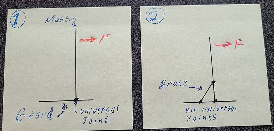

  • #114
So:
Yes I understand evertything you said and 100% agree with all what you said.
Now you tell me one think,do you understand that sailor do not hold sail like on picture below?
Also quote my words that you don't agree with me ,what I said wrong...?
  • #115
Ok, good.
Now you tell me one think, do you understand that sailor do not hold sail like on picture below?
The internal geometry is irrelevant to the points I was making, so I don't understand the point of that question. E.G.; he could do that. Whether he does or doesn't is a new scenario that hasn't been described.
I did. And you repeated it several times.
[edit] Here it is again:
here is no any torque from the wind force, because joint can't transfer torque to board.
That's wrong. There *is* a torque on the board from the wind force because a series of universal joints *can* (and does) transfer torque to the board.

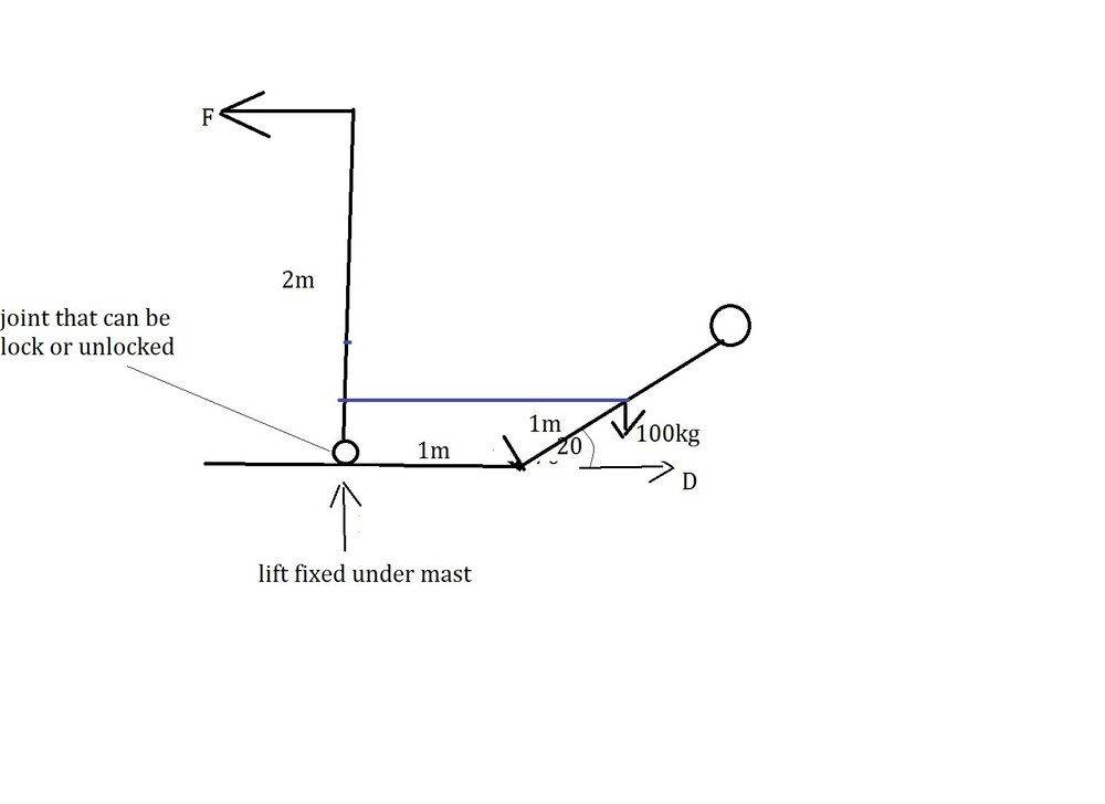

John Mcrain said:
once again
Do you understand that left weight scale will show 0kg for every scenario where blue line and mast force is 100% horizontal, feet must stay above right scale, and system must be in equlibrium?
Certainly not. You must be adding assumptions/constraints you aren't saying (or you're just wrong). The bad grammar doesn't help either. I'll not speculate about an under-defined scenario. Draw all the forces and label all the lengths, and solve for your scenario.
You're jumping around so much here that it is difficult to know what your ultimate goal is. That makes it look like your ultimate goal is a never-ending argument.
Likes jbriggs444 and pbuk

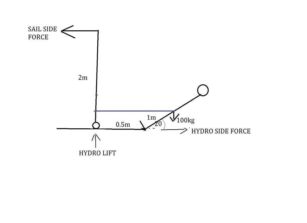

John Mcrain said:
Sailing boat has pitching moment caused by sail drive force and hydrodnamic drag froce in the water,distance between them is lever arm.
It cause nose of boat to push down..
Does windsurfing has pitching moment and if yes how it is transfer to the board ,if sail is connected to board with universal joint and sailor feet also act as joint. But joint can not transfer moment..?

John Mcrain said:
once again
Do you understand that left weight scale will show 0kg for every scenario where blue line and mast force is 100% horizontal,feet must stay above right scale,and system must be in equlibrium?
The single fixed foot is not a realistic model for two feet with variable load sharing. In wind surfing, the center of pressure of the feet combined and the center of mass of the rider are not fixed.

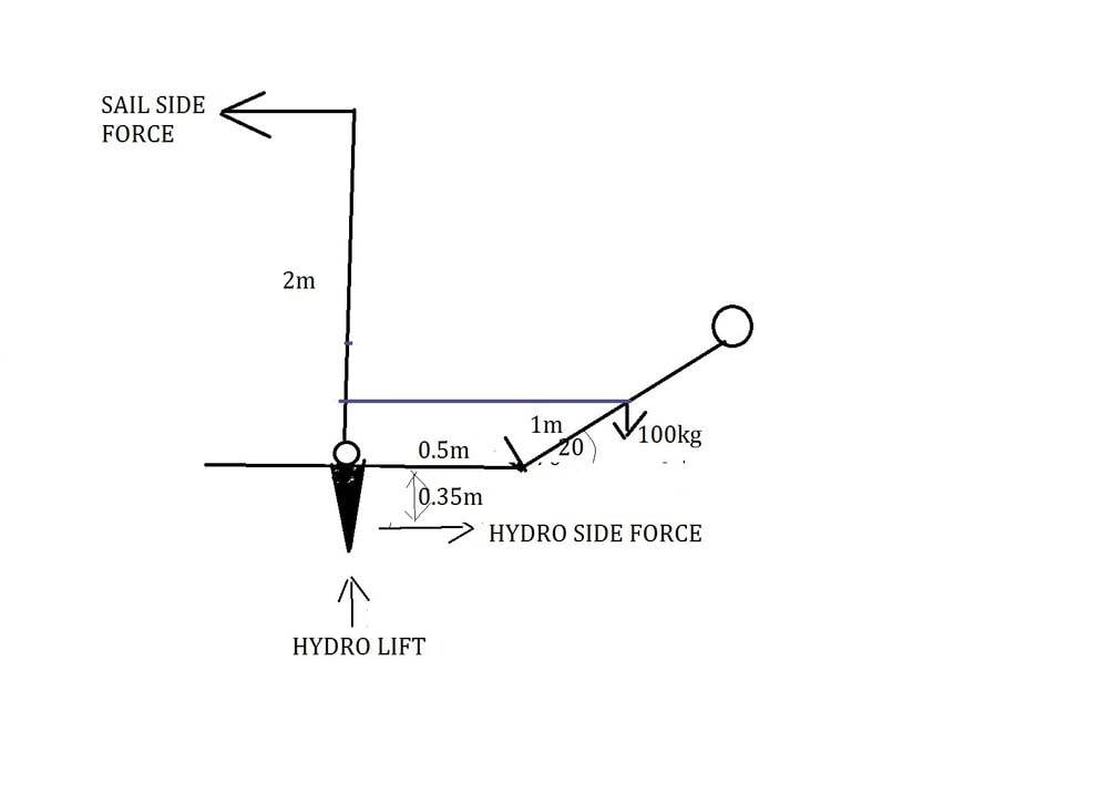

Find position and magnitude of lift force,system must be in balance..
first for sailor lean out angle 70 then for 20 degress
My results : lift position is for both case(70deg and 20 deg) below sailor feet and magnitude for both case is 1000N
mast force for 70deg case= 171N
mast force for 20deg case=469N
(I use 1kg=10N)70degress
20degress
  • #125
View attachment 27914220degress
Edit; Sorry, I do see now that this is a complete answer. Ok, yes, I agree. Now what?
  • #126
70degress
So these are figures for the 2-meter-high wind force that will be balanced by the surfer's tension on a horizontal line at 70 degrees and at 20 degrees. Yes, I agree. In both cases, the result is ##\frac{mgh \cos \theta}{H}##
We have the board+mast+sailor all balanced on a point support located at the sailor's feet. The farther back the sailor leans, the more clockwise torque from gravity about the support point. And the more counter-clockwise torque from wind that can be resisted.
In the toy model where the line is horizontal, it all boils down to a simple balance between sailor position and wind force.

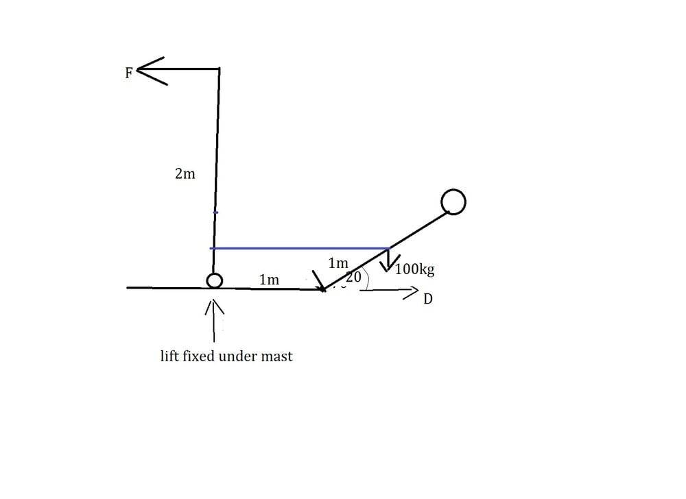

  • #129
You ask me to prove math..here you are..
First, there is now need for any calculation for this easy case where line and mast force is horizontal,it is pure logic that lift force must be under sailor feet for both case for two reason.
1) line is horizontal so sailor don't "loose" any weight under his feet and don't produce any internal vertical force at joint
2)external mast force is horizontal so no any internal vertical force at joint
case 20degrees
1) find tension in rope T
calculate from moment at feet Mfeet=0
100kgxcos20 -Txcos70=0
T=274.4kg
2)calculate mast force
Mjoint=0
-Fx2m + 274.4kg x0.342m=0
F=46.9kg...469N
3)find Lift position and magnitude
magnitude is same as sailor weight...100kg=1000N clear as glass
Mjoint=0
-46,9kgx2m +100kgx1,9396m -100kg x X= 0
X=1m ...1meter right from joint is sailor feet..
double check with internal forces
Mjoint=0
100kgx1m -100kgx X=0
X=1m
(If line has some downard angle and mast force is horizontal,lift position will be somewhere left from sailor feet...that I can say just from logic,but in this case,I can't say accurate position without calculation..)
First, there is now need for any calculation for this easy case where line and mast force is horizontal, it is pure logic that lift force must be under sailor feet for both case for two reason.
It's dangerous to assume you don't need math. That's an easy path to making mistakes.
In any case, this model doesn't take into account the weight of the board and sail/mast/boom. The force on the left scale isn't zero (and the force on the right scale does not equal the riders weight), but they are the same between the two scenarios. Maybe that detail isn't important to whatever point you are trying to make, though, I don't know.
(If line has some downard angle and mast force is horizontal, lift position will be somewhere left from sailor feet...
I agree with that as well. So now what?

If evertyting is same just mast has fixed conection:
mast force will be
100kgx1,939m -Fx2m=0
F=96,98kg...969,8N
And lift magnitude will be 100kg..1000N and lift position will be under mast
Am I right?

  • #132
mast force will be
F=96,98kg...969,8N
Am I right?
...[edit] dang, multi-tasking again. Hang on.

  • #133
russ_watters said:
Yes.
So you see that mast connection make difference.
So I can not look at first case with joint like it is rigid(welded mast)
What does it mean in practice,if I have fixed mast I can increase righting moment=increase sail power =go faster??
  • #134
Sorry, no, I misread while multi-tasking. It was confusing when you said "everything is the same" and then started changing things.
If the only physical setup change is that you've added guy-wires to the mast, then nothing about the force balance changes.
  • #135
But what is then wrong with my calculation,for joint case mast force is 469N and for fixed conection mast force is 969N.What did I wrong ?
  • #136
John Mcrain said:
But what is then wrong with my calculation, for joint case mast force is 469N and for fixed conection mast force is 969N.What did I wrong ?
I think you assumed that the fixed mass applies a torque at the attachment point.
  • #137
No, this does not make any sense.
You said that you 'keep everything the same', just fix the mast but you have NOT kept everything the same, you have changed the wind force on the mast.
In the diagram where the mast is 'not fixed', the lift point is only directly below the sailors feet because you have fixed it that way: you have assumed that there is no other torque on the board (for example due to buoyancy or tail fin drag) and so in order for it not to rotate the centre of lift has to act at the feet!
You have proved nothing about your 'model' of the side view of a windsurfer, but it is pointless discussing this model anyway, it is nothing like a real windsurfer which looks like this:
