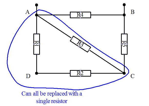

In the Circuit(pic attached) the following resistor combination is found.
All the resistrs in the figure has resistance R ohms.
What is the total resistance across AB?
V=IR
3. The attempt at a Solution
between point A and B there is only one resistor so i thought the answer is R

No, there are multiple paths that current could take from A to B. Look for opportunities to combine series and parallel resistances to reduce the circuit complexity.
Your Relevant Equations should have included the formulas for combining resistances.:wink:

I could do the part i) I am stuck with the part ii)
Show your work for part (i) and what you've tried for part (ii).

Part i) work is good.
For part ii), can you not spot any series or parallel connections? What type of connection relationship do resistors AD and DC have?

yeah i noticed that resistors ad and dc are in series. Then resistors ac is parallel with ad&dc. so the only resistor left out is bc

Yes, so can you reduce the whole network down to a single resistance?

no. I really have no idea how to include resistance ab and bc in the circuit
You've already identified that AD is in series with DC and so can be replaced by a single resistor, say "ADC". You also pointed out that this ADC is in parallel with AC, so that pair in turn can be replaced with a single resistor. What's the value of that resistor?
Redraw the circuit with that new resistor in place and the remaining resistors.
Likes Hashiramasenju
I think i got it 5R/8

Looks good.
