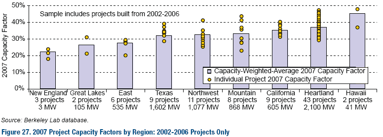

-Modern wind turbine capacity factor has been growing, reaching 36% average for US 2005 farms, with some hitting 45%, Figure 2-4. I've read elsewhere turbine capacity is expected to reach 40% average eventually.

Nope, common mistake. You were using the price in the ref given for the turbine nameplate rating. The 1.5MW is nameplate, or maximum turbine power. Those wind turbines need to be derated to an average 37% capacity factor; that's the best average production coming from 2006 turbines installed in good US wind locations. Also, that ref 2005 price of slightly less than $1000/ Nameplate kilowatt is a bit dated now. Wind cost has risen since then given the wind installation spike, and sharply recently due to inflation (steel tower/concrete costs) so that now wind installation is now closer to $1700/kilowatt (nameplate). The cost then to provide 2.87GW average power to those pumps solely from wind is more like 8 to 12 billion dollars. That also does not include any transmission needed, though you might need that regardless of source, and we've neglected any cost required to regulate the wind power via the water flow.
www1.eere.energy.gov/windandhydro/pdfs/41869.pdf

  • #69
Ok. So it'll take 10 years for the wind farms to pay for themselves.
Some more interesting numbers can be derived from the given reference:
$1.70 "now wind installation is now closer to $1700/kilowatt (nameplate)" ($/watt) (ref: mheslep)
5600000000 "a total capacity exceeding 5,600MW" (watts) (http://www.power-technology.com/projects/callahan/" )
$9,000,000,000 "with annual revenues of more than $9 billion".(ref1)
$9,520,000,000 initial total investment (ref1 capacity * $1.70/watt)
0.37 mheslep capacity factor(I searched your pdf reference for "37" and couldn't find it.)
8549 hrs/year
47,875,968,000 kwh/yr (=0.37*5.6GW*8549/1e6)
$0.19 $/kwh (=$9e9/47.9e9kwh)
So using your numbers and theirs, it would appear that they now have annual revenues slightly less than their total worst case investment. Perhaps their windmills ended up paying for themselves.
btw, that was an excellent reference you provided: www1.eere.energy.gov/windandhydro/pdfs/41869.pdf
248 pages of numbers. Pure Cheeto candy.
