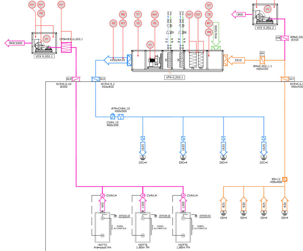

Hey everyone,
I am an energy modeling engineer, and I would like to ask a question regarding a project I am working on.
In the attached instrumentation diagram (and I also found this on AHU specification tables), what does it mean to have "air flow1/air flow2" (see figure). I deduce it is the "min airflow value/max airflow value", but I would like to be sure about this. Concerning colors, orange is return air, green is outdoor/fresh air supply, blue is primary air and pink is exhaust air.
Thank you all in advance for your time.

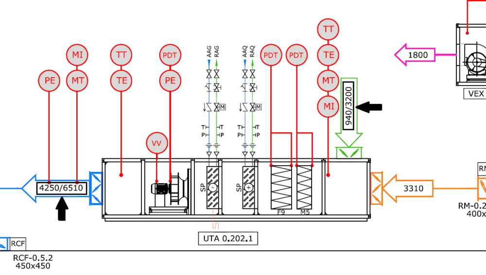

That's a good guestion, but I am unable to zoom that image big enough to read what you are saying. Can you add a post with a close-up of the part of the image showing the label in question?

Thank you, and thank you again for the fast repply.

Thank you. min/max would be my guess also. Wait a while for others to weigh in also.
Label conventions sometimes seem irrational unless you know the underlying thoughts.
Likes redux
That's what it looks like, yes; it's probably reduced outdoor air and exhaust when the washer is off.
