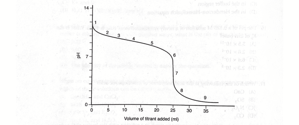

(see below)
titration curve
pH + pOH = 14
at halfway point:
pH=pKa
pOH=pKb
What is true about the pK of the analyte?
a) pKa = 9.2
b) pKb = 9.2
c) pKb = 4.8
d) pKa = 11.7
The halfway point is at point 4, at approximately pH=9.2. Therefore, the pOH = pKb = 4.8, and I think the answer is c).
The solution says b) is the correct answer. Could anyone explain why, or whether or not my answer is correct? Thanks.
Solution is wrong.
Not that you are entirely right, c is not the only correct answer.
