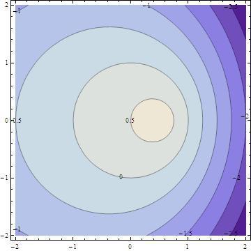

OK keji8341, here we go. Without loss of generality I will use two reference frames in the standard configuration with the point source at rest at the origin in the primed frame, and I will use units of time such that in the primed frame w=1 and units of distance such that c=1. Then, in the primed frame we have:
r&#039;=\left( t&#039;,x&#039;,y&#039;,z&#039; \right)
k&#039;=\left(1,\frac{x&#039;}{\sqrt{x&#039;^2+y&#039;^2+z&#039;^2}},\frac{y&#039;}{\sqrt{x&#039;^2+y&#039;^2+z&#039;^2}},\frac{z&#039;}{\sqrt{x&#039;^2+<br /> y&#039;^2+z&#039;^2}}\right)
\eta_{\mu\nu}k&#039;^{\mu}k&#039;^{\nu}=0
\phi=\eta_{\mu\nu}k&#039;^{\mu}r&#039;^{\nu}=t&#039;-\sqrt{x&#039;^2+y&#039;^2+z&#039;^2}
Boosting to the unprimed frame we get
r^{\mu}=\Lambda^{\mu}_{\nu&#039;}r&#039;^{\nu&#039;}=\left(t,x,y,z\right)
k^{\mu}=\Lambda^{\mu}_{\nu&#039;}k&#039;^{\nu&#039;}=\left(<br /> \begin{array}{c}<br /> \frac{v (t v+x)}{\left(v^2-1\right) \sqrt{-\frac{(t<br /> v+x)^2}{v^2-1}+y^2+z^2}}+\frac{1}{\sqrt{1-v^2}} \\<br /> \frac{t v+x}{\left(1-v^2\right) \sqrt{-\frac{(t<br /> v+x)^2}{v^2-1}+y^2+z^2}}-\frac{v}{\sqrt{1-v^2}} \\<br /> \frac{y}{\sqrt{-\frac{(t v+x)^2}{v^2-1}+y^2+z^2}} \\<br /> \frac{z}{\sqrt{-\frac{(t v+x)^2}{v^2-1}+y^2+z^2}}<br /> \end{array}<br /> \right)
\eta_{\mu\nu}k^{\mu}k^{\nu}=0
\phi=\eta_{\mu\nu}k^{\mu}r^{\nu}=\frac{-\sqrt{1-v^2} \sqrt{-\frac{(t v+x)^2}{v^2-1}+y^2+z^2}+t+v x}{\sqrt{1-v^2}}
k behaves as you would expect for the wave four-vector. E.g. for y=0 and z=0 we get
k^t=\frac{1-v \; \text{sgn}(t v+x)}{\sqrt{1-v^2}}
which is the standard expression for the relativistic Doppler effect including the sign change as the point source passes a given location on the x axis. Off of the x-axis the Doppler shift depends on both position and time, as you would expect from everyday experience. Also, as I stated above, the spacelike part of k is not generally parallel to the spacelike part of r.
phi also behaves as you would expect for the phase of a moving point source. Surfaces of constant phase form light cones centered on the location of the point source at t=\phi. The formula is valid as close to the point source as you like.
PS k is written as a colum vector just so that it would fit on the screen width easily

  • #75

  • #76
2 is incorrect, see above. Your constraint is false.
  • #77
Sorry. Let me reiterate it to see if I got your idea.
1. In the source-rest (X'Y'Z') frame, the wave number vector is given by k'=(w'/c)(x'/|x'|), with k'//x', and the corresponding 4-vector is (k',w'/c), so that (k',w'/c).(k',w'/c)=0. phi'=w't'-|k'||x'|, phi'=constant is a spherical surface.
2. From Lorentz transformation, get (k,w/c), with |k|=w/c. phi=wt-k.x, but with k not //x.
3. The Doppler formula is w'=w*gamma*(1-beta.x/|x|).
No math problems, but two physical problems come:
(1) The frequency is indeterminate at overlap-point, which is the same as Einstein's formula.
(2) Because k is not //x, phi=wt-k.x=constat is not a spherical surface, which is not physical (physical law not covariant).
That is why I said that there is a strong constraint between x' and k', which destroyed the covariance.
  • #78

This does not follow. |x|=r is indeed a spherical surface with radius r centered about the origin, but it is not the only spherical surface. For example, |x-x0|=r is also a spherical surface with radius r centered about x0. Remember, the point is moving, so not all of the spheres of constant phase will be centered on the origin. Only the sphere of 0 phase will be centered on the origin.
Here is a contour plot of the lines of constant phase for t=1, z=0, and v=-.6. Note that the contours of constant phase are circles, note that only the line of phase = 0 is centered at the origin, and that it has a radius of 1 as you would expect for a wave front moving at c.
I realize that the spherical center is moving. but k.x=0 is indeed a plane.

See the contour plot I posted above, sorry about editing at the same time you were editing.
  • #92
Yes, it is very familar. But I don't think your imposed Lorentz transformation creates such a picture. k.x=0 is a plane.
Your Lorentz transformation is not a standard Lorentz transformation. In standard Lorentz transformations, (k,w/c) and (x,ct) are completely independent.

It does. I simply plotted the formula I posted above. I can post my code.

I guess you plotted the contours under the condition w't'-|k'||x'|=0 or ct'=|x'|. If so, that's the problem.

Attached is my code, completely open for inspection.
I did not do that. I told you exactly the conditions I used:
"Here is a contour plot of the lines of constant phase for t=1, z=0, and v=-.6."
There is no problem. The plot is correct and accurately reflects the familiar behavior of Doppler-shifted spherical wavefronts. This familiar behavior emerges naturally from the formalism of four-vectors and how they transform.
