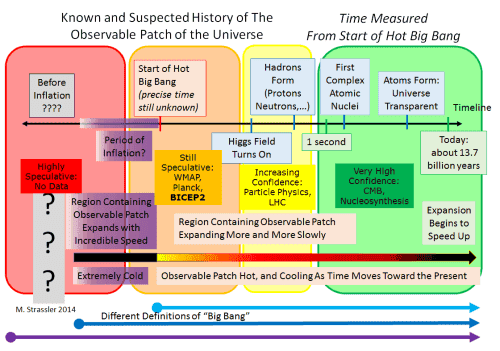

That depends on what you mean by "big bang". As you can see below, you can redefine "big bang" in order to push it further and further back in time. [If you find it practicable. I sincerely don't know why people insist on doing this. It is my failing of imagination.]
Inflation removes the singularity that used to be attached to the start of the Hot Big Bang. As I understand it (not having studied general relativity) the removal is inherent:
"Hence general relativity cannot be used to show a singularity.
Penrose's theorem is more restricted, it only holds when matter obeys a stronger energy condition, called the dominant energy condition, which means that the energy is bigger than the pressure. All ordinary matter, with the exception of a vacuum expectation value of a scalar field, obeys this condition. During inflation, the universe violates the stronger dominant energy condition (but not the weak energy condition), and inflationary cosmologies avoid the initial big-bang singularity, rounding them out to a smooth beginning."
[ http://en.wikipedia.org/wiki/Penrose–Hawking_singularity_theorems ]
Maybe something that could be said to break down spacetime reasserts itself "later" if we manage to look further back in time. (I assume then as a result of exotic physics.)
In the meantime, it is much more generic to identify various definitions of big bang to a certain time, meaning the space volume experienced it "everywhere at once". (Whatever "it" means for you.)

You are getting confused because of the two radically different ways the term "big bang" is used. One way, the only way in my opinion that is meaningful or helpful, is the "Big Bang Theory" which is a very (but not completely well understood description of how the universe evolved starting at about one Planck Time after the "singularity" and saying NOTHING about anything before one Planck Time (other than "don't know WHAT was going on back then") and the other is just a reference to the singularity (more properly called the Big Bang Singularity) which is just a place where the math model breaks down and something we can't really say anything meaningful about (other than "don't know WHAT was going on back then")
Also, I would suggest that you refrain from saying that anything started out at a point and just say that it started out at a TIME and we don't know HOW it started out but we know a lot about what happened since then.
