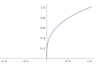

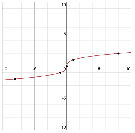

Dear all,
I was using the computer in order to plot the graph of
\[y=x^{\frac{1}{3}}=\sqrt[3]{x}\]
and two different plotters gave two different results. I don't understand why. Can you kindly explain ?
The results are:
Thank you !

First, of course, those are the same for x> 0 just scaled differently. As for x< 0 it looks like the first plotter is using logarithms "unthinkingly" to calculate fractional powers and the logarithm of negative numbers do not exist.
Generally $x^{1/3}$ is considered to be undefined for negative $x$, although some books do effectively define it as $-(-x)^{1/3}$.
Reasons are:
  1. The power identity $a^{b\cdot c}=(a^b)^c$ breaks down. Consider:
    $$-1 = (-1)^{2/3\cdot 3/2} \ne ((-1)^{2/3})^{3/2} = 1^{3/2} = 1$$
  2. Calculators evaluate it as $x^{0.33333}$, which is undefined for negative x.
    Note that we can only define something like $x^{1/3}$ for negative x if the power is a fraction with an odd number in the denominator, but that is generally not supported by calculators.
