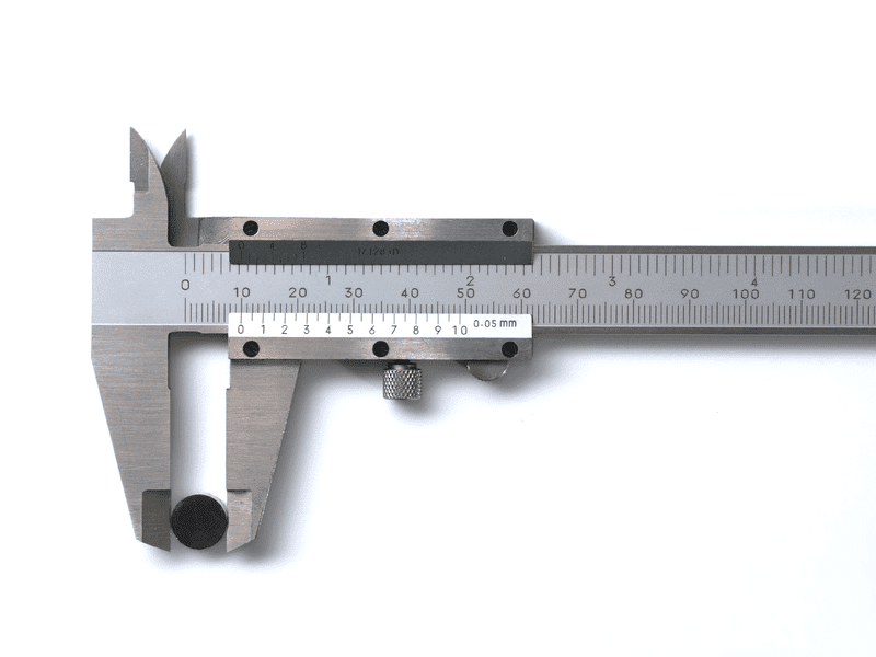

Can you post a few pictures of the typical fittings and piping that you are working on? Also, do you have a pair of calipers that you can use to measure the OD of some of the pipes and fittings? Do you have a small ruler with fine inch and mm scales that you can use to measure the # of threads per inch/cm, etc.?
https://upload.wikimedia.org/wikipedia/commons/1/18/Caliper_detail_view.jpeg
Hello Berkeman, unfortunately I don't have any photos just now
I do have caliper and its metric only same as tape, I think I understand now what I need to properly measure
