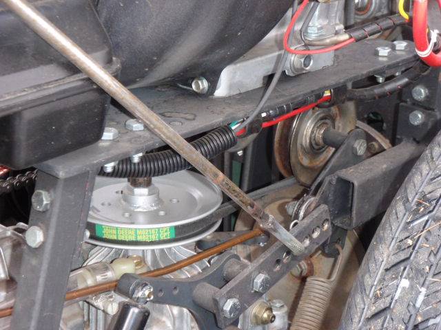

Make sure you cover ALL areas. You will need a control valve, hoses and connections plus pump and motor. You can arrange for the drive belt to have a quarter twist if you have to to drive a hydro transmission with a vertical input shaft with the Kohler motor you have by using some inexpensive idlers.

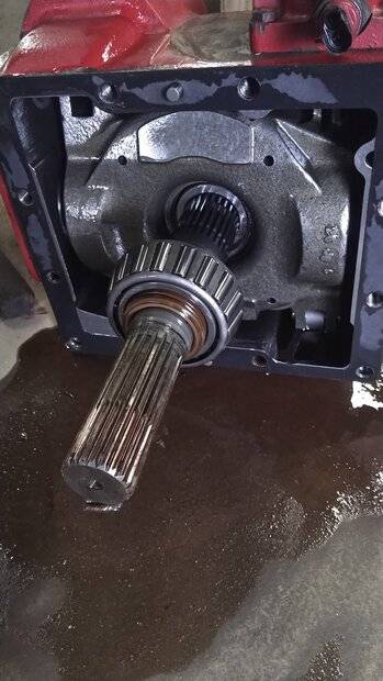

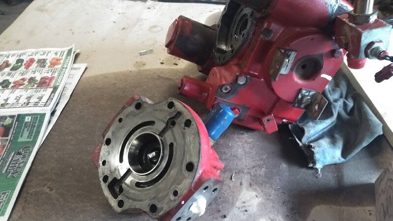

Most hydro systems use a variable displacement pump to control the speed. Some will have a method to change the pitch of the swash plate in the motor to give a high and low range. So far as I can tell, your plan to vary the speed is to simply bypass the oil you don't want to go through the motor. This is a poor plan. You will have poor speed regulation if you have any at all.
A real hydro pump looks like this. You can see one of the servo cylinders from the outside and the back side of the swash plate. Hydrostatic drives are NOT about diverting flow.

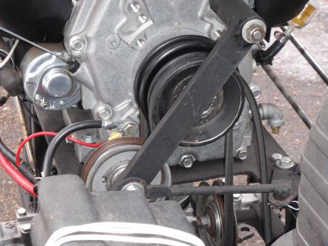

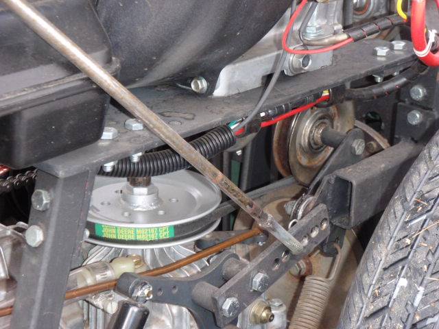

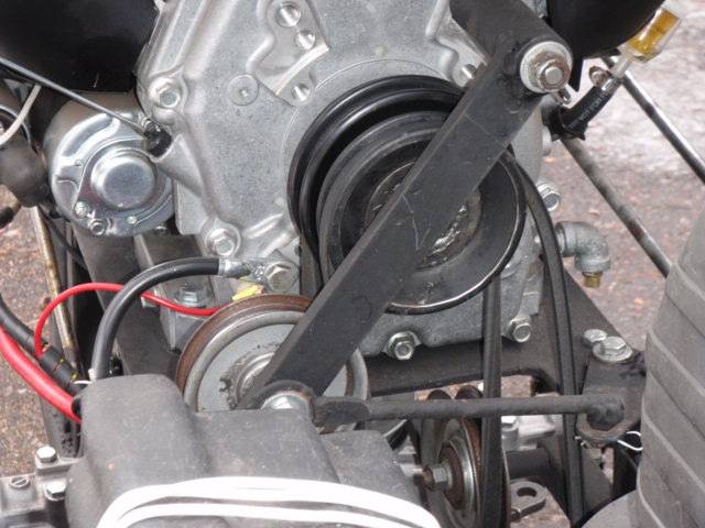

As I did with my snowblower:

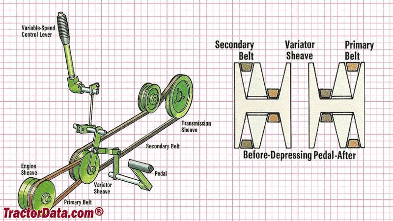

Essentially, yes. The lawn tractor the motor and transaxle came off of used a variable pulley system (called a variator) as a clutch. Since I want to reconfigure how the motor is oriented and don't want to recreate that system, a hydraulic system that can replace the clutch function seems like the better option.
I should also point out that the K241 uses a speed governor throttle control. The motor is set to operate in ranges from 1700-3500 rpm. However, to reach max rpm, even under a normal load of moving the tractor by itself, the throttle will only open up to about 30% WOT. Increasing the load will make the throttle open up more to maintain the max rpm at 3500. I think I can compensate for those losses with some clever pulley selection.
