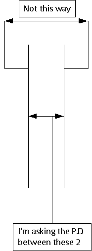

Suppose we're measuring the P.D of a parallel plate air capacitor from the inside (i.e from the side the 2 plates face each other), will it be different to when we measure it the normal way (like when discharging it)?

I'm talking about a parallel plate capacitor and the P.D from its inside, i.e not the way we usually connect the capacitor to the external circuit but the path though which the dielectric leakage occurs.
You did not get the question, and I think no one did.
I think he's asking whether there would be a difference between the P.D. from the outer sides of the parallel plate capacitor and the inside sides (the distance between the "inside" sides of the capacitor differs from the "outer") Actually I don't really get it either, do we assume that the plates have negligible thickness for parallel plate capacitors?
Yes.
Ok, this might explain -

Yes, that is how I understood your question. Again, the answer is that the voltage is the same. The potential difference is the amount of work required to move a charge in an electric field. Inside a conductor, there is no electric field at steady state because the charges are free to rearrange themselves to cancel out any applied electric field. This means that no amount of work is expended to move a charge from the terminal to any point on attached plate. Thus, the potential difference between the terminals is the same as the potential difference between any two interior points across the plates barring the variations in the voltage due to the finite size of the parallel plates.

You should note that when we calculate the voltage and charge distribution of an ideal 1D parallel plate capacitor that we do not bother with terminals or care about the thickness of the plates.
Thickness doesn't matter anyway.
The plates can be infinitesimally thin, in which case there isn't a difference between the inner or outer sides, they are the same.

1) Assume there is a potential difference from one side of a plate to the other.
2) Charge will flow until the diference in potential is zeo.
3) The potential across any plate under static conditions is zero.
4) Therefore the potential difference is the same, measured from the inside of the plates, or the outside of the plates.

This is what I have been repeating through this whole thread. The is no voltage drop across any two points on a continuous conductor when we are at steady state in electrostatics. This is because there is no electric field inside a conductor. This is because charges will always arrange themselves such that they perfectly cancel out any applied electric field in a conductor. Thus, because there is no electric field inside a conductor, then no work against an electric field needs to be done to move a charge which means that the voltage drop is zero. This means that the voltage between the inner and outer edges on a the same plate is zero.

I think i get it. The plates are conductors so that means they are equipotential surfaces--every point on the surface of the plates are at the same potential.
