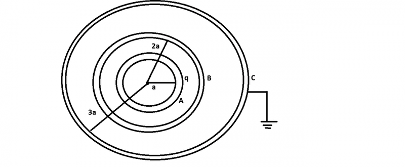

A,B and C are three concentric metal shells of radii a,2a and 3a .Shell A is the innermost and shell C is the outermost .Shell A is given a charge q and C is earthed.Find the final potential of shell B.
##V##=##\frac{Kq}{r}##
Charge q' is supplied from Earth to shell.
Then charges will be induced
Now we have to find q'
Potential of shell C should be zero.

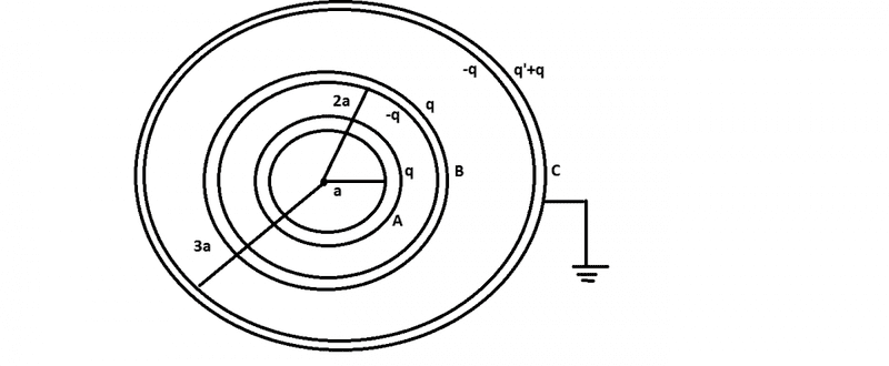

##\frac{K(q'+q)}{3a}## - ##\frac{Kq}{3a}## +##\frac{Kq}{a}## - ##\frac{Kq}{a}## +##\frac{Kq}{2a}## =0
##\frac{K(q'+q)}{3a}## - ##\frac{Kq}{3a}## +##\frac{Kq}{2a}## =0
##\frac{K(q'+q)-Kq+\frac{3Kq}{2}}{3a}##=0
##K(q'+q)####-Kq##+##\frac{3Kq}{2}##=0
##\frac{2K(q'+q)-2Kq+3Kq}{2}##=0
##2K(q'+q)##-##2Kq##+##3Kq##=0
##2K(q'+q)##+##Kq##=0
##2K(q'+q)##=##-Kq##
##2(q'+q)##=##-q##
##q'+q##=##\frac{-q}{2}##
##q'##=##\frac{-q}{2}##-q
##q'##=##\frac{-3q}{2}##
Now by putting value of q' we can find potential of shell B by all the charges present.Am I right till here?

Your expression for the potential at C is all wrong.
Hang onto these facts for uniformly charged conducting spherical shells:
- outside the shell, the potential and field generated by the charge on the shell is exactly the same as if the whole charge were concentrated at the centre of the sphere. (So what is the potential at C that results from the charge on A?)
- there is no field between the inner and outer radii of the shell, so the potential is constant in the annulus.
- there is no field generated by the charge on the shell inside the shell, so the potential it generates there is also constant and equal to the potential it generates at the shell itself. (Don't confuse this with the net potential at the shell.)
Gracy, if shell C were not grounded, do you agree that the charge induced on its outer surface by charge separation due to the charge on shell A would have been +q?
If so, then adding the ground connection would allow that +q charge to "escape" to ground. Or, thought of in another way, ground would supply a charge of -q to cancel that +q charge. The end result is that a charge of -q moves onto shell C through the ground path. This charge of -q serves to terminate the field lines of the interior charge +q of A shell, and so shell C exhibits a zero potential to the external world.
So you end up with shell A holding a net charge of +q, shell B holding a net charge of 0, and shell C holding a net charge of -q.
Given these shell charges you can apply the facts listed by @haruspex to find the potential at the location of shell B. Note in particular that an isolated uncharged shell (such as shell B) will not contribute to the potential. Only net charge on a shell will do so. The fields created by charge separation serve to cancel the field inside the conductor comprising the shell (so no currents continue to flow) and matches the external field at the boundaries of the conductor. That is to say, superposition of the external field and the field produced by the separated charges renders the net field inside the conductor (within the shell material) zero, but doesn't change the external field or potential.
In the end, the potential at the position of shell B will be the superposition of the potentials due to the net charges of shell A and C.

Suppose charge q' has been supplied by Earth as we know shell C has been grounded it's potential should be zero
##V_C##=##\frac{Kq}{3a}##+##\frac{Kq'}{3a}##=0
Therefore q'=-q
##V_B##=##\frac{Kq}{2a}## - ##\frac{Kq}{3a}##
=##\frac{Kq}{6a}##
Right?

As haruspex said, we don't "neglect" the potential due to the induced charges. But since their contribution varies at each point, there isn't a general formula( like kq/r for net charge). Hence, only the net charge appears in the formula since it decides the net potential. In the net potential kq/r, potential due to induced charges is already included,hence, there's no need to calculate it separately if the "net potential" is asked. But to calculate the contribution of induced charges, as you said, you should consider the induced charges and the geometry of the system. Seeing the math you've done,
I believe you've understood the concept very well now!
