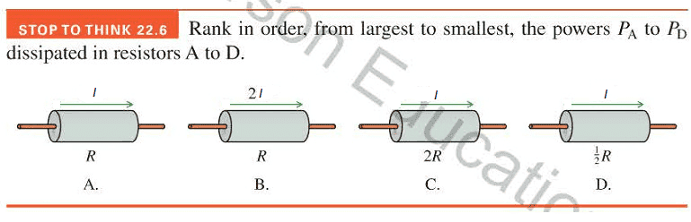

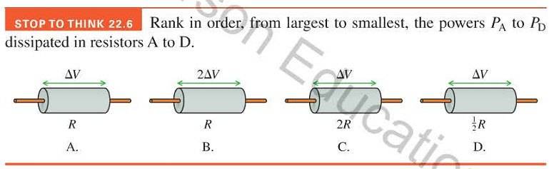

imgur: http://i.imgur.com/9VILpYL.jpg
Now, I can easily solve this by applying the formula [itex]P_R = \frac{(\Delta V_R)^2}{R}[/itex] and get all the correct answers.
However, the answers feel strange to me intuitively. In the formula above, lowering the resistance increases the power that is dissipated.
Shouldn't a device with MORE resistance dissipate MORE energy per unit time? After all, isn't the idea behind something like a superconductor that it dissipates no energy while carrying it, and thus, wouldn't convert any of the flowing currents energy into heat.
Or am I misunderstanding the meaning of what it is to dissipate power? I thought it was just heat. Shouldn't something with more resistance get hotter, thus dissipate more power.
Or is it a matter of power vs energy? Is it that a higher resistance converts a higher fraction of every Joule of electrical energy into heat, but doesn't allow as much current, and so makes the conversion more slowly?

You're comparing one resistor to another, each with the same current. In that case the one with the larger resistance consumes more power. This would be the case, for example, when two resistors are connected in series.
Imagine instead comparing two resistors with the same voltage across them, each having a different amount of current flowing through them. The one with the larger resistance consumes less power. It has the smaller current flowing through it. This would be the case, for example, when two resistors are connected in parallel.

You have four equations, and they all apply in all circumstances:
V=IR; P=IV; P=V2/R; P=I2R.
If you increase the resistance, one or both of V and I must also change. If by some means I is held constant then these equations tell you that V and P must increase. Alternatively, if V is held constant then I and P must decrease.

Suppose you had instead been given this problem:
Resistors in series have the same current through them. But that's a special case, not the general case.
Another special case is when resistors are in parallel. Then they have the same voltage across them.
I recommend you work out the solutions to both problems using only ##\Delta V_R=IR## and ##P=I\Delta V_R##.

I think that that you may be thinking about this too hard. Instead of thinking of P=V^2/R use the other definition of P=VI, which may be more intuitive. Also remember Ohm's law is V=IR. Remember that I is the current going through the resistor and V is the potential across the resistor. The thing is, if you have a constant voltage and the decrease the resistance, the current will go up therefore the power goes up and vice-versa. Likewise, if you keep a constant resistance and increase the voltage you will also increase the current and therefore the power goes up. You can change the voltage, current, and resistance so long as R=V/I holds, and I think this is what is confusing you. I'll give you a few quick ideal examples similar to the situations you posted.
Take an example circuit with a 1V battery across a 1 ohm resistor. In this case the current would be 1A, leading to a power of 1W.
Now use a 2V battery with a 1 ohm resistor, which makes a current of 2A, leading to a power of 4W.
Now use a 1V battery with a 2 ohm resistor, which makes a current of 0.5 A, leading to a power of 0.5 W.
Lastly, use a 1V battery with a 0.5 ohm resistor, which makes a current of 2A, leading to a power of 2W.
This is a very simple example, but this was just to illustrate how the voltage, current, resistance and power are related. I hope this helps.
