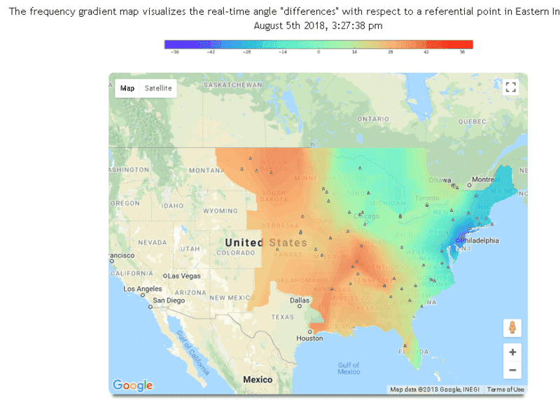

That's what that Grideye site that i cited earlier shows. Here it is right now.
right now all that coal in the Dakotas and along the Mississipi, the Nukes in TVA and natural gas in Texas are making more power than the residents there are using. So that region's generators are running a few degrees ahead of those in the Northeast.
Same frequency , just our generators are a fraction of a turn ahead of those in New York. From the looks of that map perhaps as much as 45 electrical degrees.
So--- Power flows from the brownish region where i live toward the blue where some of my kids live.
Too bad the Pacific Northwest part isn't working , it'd be interesting to see what the hydro is up to. Lots of aluminum smelters out there- they're high consumers of electricity.

dlgoff said:
I was told while working for a power company that typically power "flows" west to east. What's your take on this? Sounds reasonable when not considering large disturbances.
It sounds like nonsense, but in real life it is probably true. As @jim hardy said, from the Heartland to the East Coast. It is also true on the West Coast; power flows east and south to reach southern California. There are several plausible reasons.
  1. Coal & Hydro. Especially in western Pennsylvania and Ohio, power plants were built at the mouths of coal mines. It is easier to transport electricity than coal. Niagara Falls power flows east, Ontario and Quebec hydro power flows southeast. In the West, huge power plants such Navajo, and Palo Verde ship a lot of power westward, and hydro power from the NW flows southward, coal power from Idaho and North Dakota also flows southwest. It's true even in Europe. Look at the map to locate hydro, wind, and coal resources, and compare that with population centers. It is not an east-west bias, but a rural-to-urban bias.
  2. Wind. The wide open spaces and flat landscapes of the heartland are ideal for wind power. The owners of that power would much rather sell it in the East where prices are higher.
  3. NIMBY. On both coasts, the rich privileged people would much rather import electricity than to have a power plant in their back yard. Even green power. Think of the resistance to offshore wind from the residents of Nantucket.
Likes dlgoff, Fisherman199, Asymptotic and 1 other person

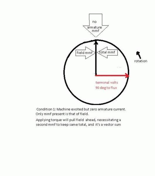

Before we learn DQ we learn Power = VICos(angle) and spend hours doing polar-rectangular conversions. I was sort of waiting for that subject to broach...
I use those phasor diagrams showing MMF's relative to terminal voltage and they work well for a single machine. But not so well for interconnected machines.
Carry On, Men, for you're better teachers than i .
