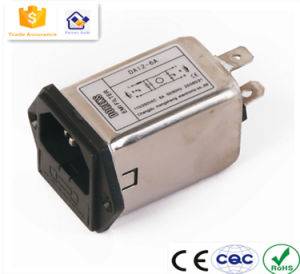

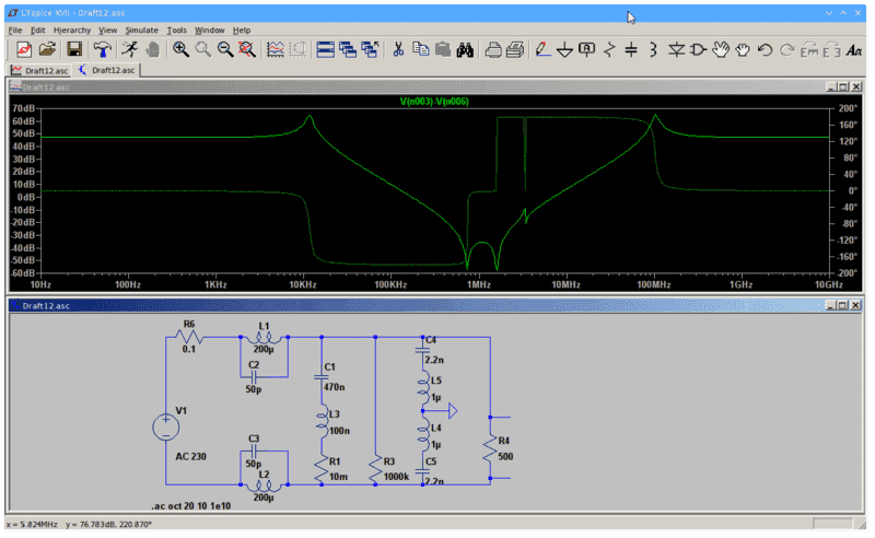

Dear forumers,
I need a 50hz 250VAC power line filter for an EMI shielding faraday cage. The filter should work between 100khz and 20ghz, attenuation should be >=60dB between 1mhz - 5ghz.
Regular power line EMI filters like this
don't seem to go that high (only up to a few hundreds of mhz or so).
I see that there are professional feedthrough filters
that do the filtering alone but they are quite expensive.
So I am thinking about using a cheaper feedthrough filter or capacitor (one that starts to filter above 10mhz) in combination with the regular one.
The regular one's spice model would look like the one in the attachment.Has someone any experience with this combination or any counter-proposal against this?

If you want 60dB up to 5GHz, you need to pay for the expensive filter. And what are you using for your Faraday Cage? How big is it? What else are you trying to feed through the walls?
The cage's dimensions will be ~2m x 1m x 1m (not a rectangular but an irregular one). The cage is for personal use.

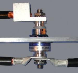

I've been reading datasheets e.g. https://eu.mouser.com/datasheet/2/382/resin-sealed-bolt-in-filters-372229.pdf
and these show that high frequency insertion loss is independent of capacitance, so in general the bigger the capacitance, the greater the low frequency attenuation. However, small capacitance (1000pf for example) filters are much cheaper.
I would also like to lead an usb and a cat-5 cable through the metal walls, these aren't that important.
So the small capacitance feedthrough filter would work as a high frequency filter (>10mhz) while the regular one would go from 100khz-100mhz or so.
Filtering at 100MHz is very different from filtering at 5GHz. Are you familiar with why this is true? :smile:
No I don't think I'm familiar with it (I'm googling it). EMI shielding papers tell that any power & data cable that goes thru the shielding must be filtered. All I know that there are parasitic properties of inductors, capacitors that makes these filters problematic to work at microwaves. So for microwaves, very small values make a big difference. Thanks for the eye opening but I don't get it. Why I couldn't insert a feedthrough filter to filter microwaves, then a regular power line filter to filter radio frequencies?
Correct.
You may be able to series-connect filters for different parts of the stop-band that you want, but there are lots of other issues to make the shielding work. Seams in your Faraday Cage welding/soldering can be a problem, for example. And if you are not careful about your filtering, you can impair the communication between the inside and outside of the cage.

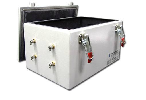

Can you say more about your application? Have you looked at commercially-available shielding solutions? I use shielded enclosures in my EE R&D work weekly, and even though I've built some of them on my own, the best solution is almost always to buy one from the available vendors (who also offer options for filtered feedthroughs)...
http://www.vicommtech.com/data/imag..._equipments/302016/manual/shielding_box_6.jpg
Likes dlgoff and flowwolf
Thanks for the answers berkeman, I'll try the series connection then, I have no idea how much it can impair the communication.
I know about the other issues (seams, gaps and honeycombs for air ventilation). I've been reading EMI shielding papers like this http://www.dtic.mil/dtic/tr/fulltext/u2/a257412.pdf for a while.
I've been checking commercial products as well, but they're out of budget in general.
I could say more about the application only in private.

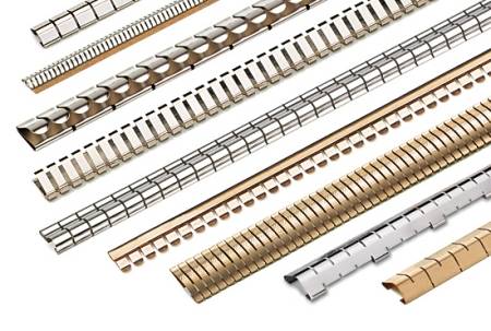

What are you planning on using for door seams and any other access port seams? Something like strips of EMI spring fingers or gaskets?
https://www.tech-etch.com/shield/images-shield/finger-stock-becu-gasket-profiles.jpg

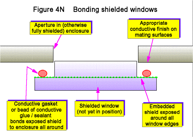

For access port seams, it depends on what it is. Power line filters can be screwed to the enclosure, but it'll likely be something custom in which case I will screw it as densely as possible.
I'm using screws with washers to join the sheets (galvanized metal sheets).
For doors, I'm not sure. There was a paper that showed EMI spring fingers are preferable over gaskets.
This is for windows but I'm planning to implement something like this (by using a thicker metal door):

For the power line filter, cheaper feedthrough filters like this one https://eu.mouser.com/datasheet/2/415/4106-000-32394.pdf
go down to 100mhz. On the contrary, filters that go down to 1mhz are ~50 times more expensive.
There are many manufacturers, but it also depends on what I can buy here..

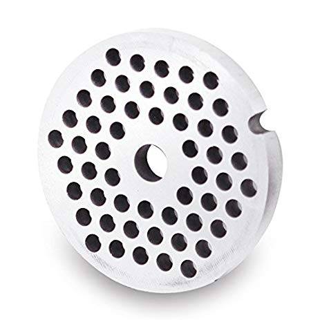

It may sound funny, meat grinder plates seem to be a cheap alternative for ventilation instead of honeycomb panels.
A grinder plate with 3mm holes and with a thickness of 15mm has a cutoff frequency of ~60ghz and works well up to 20ghz, attenuation is "160dB - 20*lg(n)" which is still >= 80dB.
