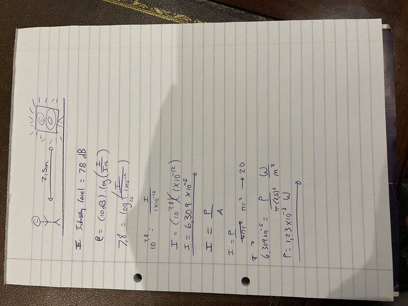

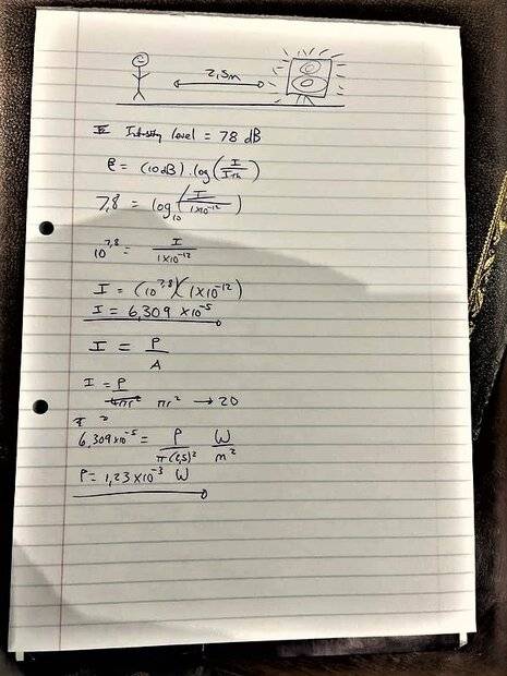

At a distance of 2.5m from your stereo system with two speakers, the intensity level is 78 dB. Assume that all the energy from the amplifier goes into producing sound. What power output does your stereo have?
B=10log I/Ith
In the picture below
Why did you change ##4\pi r^2## to ##\pi r^2##?
We're assuming the two speakers are point sources that share the same location?

Good point. More likely, the speakers are 2.5m either side of the listener.
I was not sure if the question was in 2d hence pi*r*r or 3d 4*pi*r*r.
I’m not 100% sure it is a vague question. I assumed they were in the same speaker housing maybe one was bass and one treble etcetera.
We do not live in Flatland.
It mentions specifically "two speakers", and stereo systems are not just a matter of separate woofers and tweeters; typically, a stereo system has two speaker housings, each containing a tweeter and a woofer.
The separation of stereo speakers would commonly be around 2.5m, suggesting an equilateral triangle arrangement.
However, it's not clear to me how that would affect the answer, so just take it as a point source.

Yeah, this is a very confusing problem statement.

Speaker cabinets contain at least one driver, like say a woofer and a tweeter. By their very design they are not point sources. In my opinion that's the most unrealistic feature of the problem statement.
