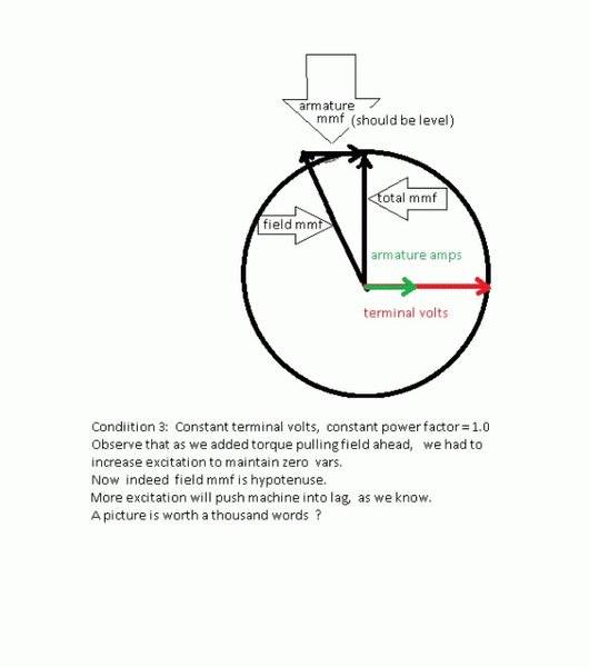

a synchronous machine.
is two electromagnets one rotating(field) and one stationary(armature) .
The armature does not rotate but its magnetic field does.
So we have two magnetic fields and if they're not aligned they will try to align,
and that makes torque.
The torque on the rotor multiplied by its RPM gives the power that results,
In that image, if we assign rotation CCW then the rotor field is ahead of the stator field so it feels a retarding torque.
The further ahead the rotor gets the stronger the torque, and the more mechanical power you have to put into the rotor.
That power goes into the armature and comes out as electrical kilowatts.
When the fields are aligned power is zero.
Maximum power is when they are 90 degrees out of alignment.
That is why speed of a synchronous machine doesn't change. Well except for the brief interval when the rotor is advancing or retarding to a new angle.
Think of the rotor dragging the stator's field when generating , and rotor being dragged by the stator's field when motoring.
girts said:
Increase rotor B field (excitation current) to have a stronger B field to drag the rotor rpm back but this increases the output voltage, and I do not see any counter mechanism against this, can you maybe explain in more detail?
Remember output voltage is set by the grid. There's a concept called "Infinite Bus" which is a voltage source so stout that your machine can't affect its voltage. That's 'the grid' and your machine is connected to it through some very small impedance.
So for this thought experiment just assume terminal voltage is fixed.
Well Now ! If terminal voltage is constant then total flux in the armature must be constant too.
Total armature flux is sum of rotor and stator fluxes
and if you change rotor flux by addig field amps, something must happen to restore total flux back to same value as before.
What might that be?
Recognize that the generator armature has inductance and Inductance is flux (linkages) per amp.
So it is plausible that additional armature current will flow and that additional armature current will restore total flux.
That is indeed what happens. If you raise field current additional amps flow in the armature, and the rotor is dragged backward toward the stator field.
Observe that all we changed was field amps not mechanical power into the rotor.
That ,means those additional armature amps must not carry any kilowatts. And they don't. They are what we call reactive amps and transmit no power.
You'll hear the term "VAR" for Volt Amp Reactive which is your reactive amps X volts.
Reactive amps flow at 90 degrees , and since power = V X I X Cos(θ) reactive amps carry no power.
That's why we say "Excitation adjusts Vars, Steam valves (or penstock if hydro) controls Watts.It's a beautifully self balancing mechanism that Mother Nature gave us.

Here's a set of three phasor diagrams i made some years ago for a thread with similar questions.
Reactive current either aids or opposes rotor field. It doesn't change torque from the turbine so it doesn't affect power . (Well except during the brief time the machine is moving to its new power angle.)..
