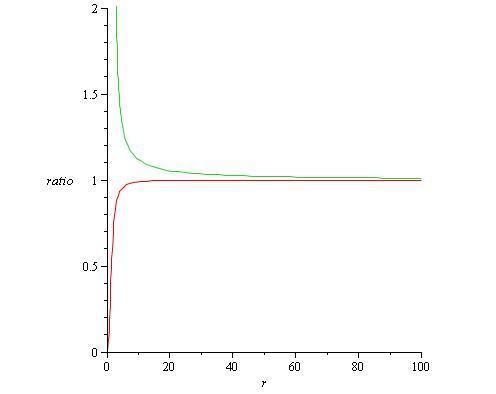

Bill's general equation which is slightly simpler can be expressed as:
##\Omega = \omega\gamma^2 - \omega\frac{3m}{r}(1-a\omega)\gamma^2 +\frac{ma}{r^3}(1-a\omega)^2\gamma^2##
where the first term is the kinematic Thomas precession, the second term is the geodetic precession due the curvature of spacetime around a gravitational body and the third term is the Lense-Thirring precession due the angular velocity (a) of a rotating gravitational body.
##\Omega## in all the above formulas is the rotation rate of a rigid rotating lattice relative to a set of gyroscopes as measured by an observer at rest with (and co-spinning with) the lattice, so the precession rate of the gyroscopes is actually ##-Omega##. The rotation rate ##\omega## of the rigid lattice is measured by the coordinate observer at infinity in the respective metric. The rotating lattice is equivalent to a congruence of observers all with identical angular velocity, (not momentum). To obtain the precession rate of the gyroscopes as measured by the observer at infinity we correct ##\Omega## by the time dilation factor and subtract the result from ##\omega## so that:
##\Omega_{\infty} = \omega -\omega\gamma + \omega\frac{3m}{r}(1-a\omega)\gamma -\frac{ma}{r^3}(1-a\omega)^2\gamma##
Note that setting a=0 gives the expected Schwarzschild precession and setting m=0 gives the expected Minkowski precession. This strongly suggests that the Thomas precession given by the second term is valid in a gravitational field and has the same sign as in flat space, contrary to some claims in the literature.
I have attached a maple worksheet that compares Bill's and Vishveshwara's precession formulas for the ZAMO case.
The hardest part is keeping track of the signs to determine the direction of precession and a lot of the literature is vague on this issue using ##\pm## signs or ##\Omega^2## to duck the issue. The NASA handouts for the direction for the Lense-Thirring precession in the GBP are full of contradictions on the direction. At the moment on balance, based on what is commonaly assumed for the Schwarzschild case, I am going with the L-T precession being retrograde. Also the MTW equation gives the opposite sign for the precession compared to the other equations. If anyone can shed some light on the direction of precession, I would be grateful.

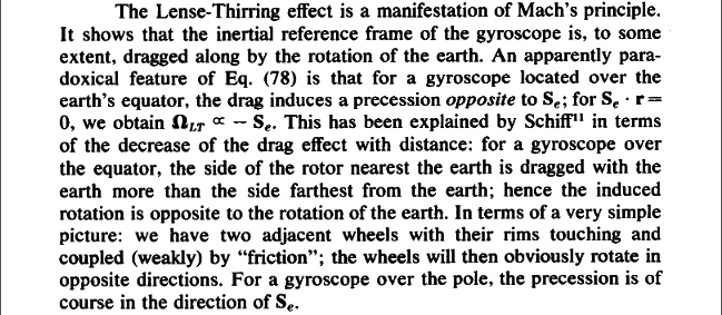

WannabeNewton said:
What may not be immediatly intuitive is the retrograde nature of the Lense-Thirring precession. Ohanian has a nice description of it's physical origin (see attachment).
Ohanian's description for Lense-Thirring precession is very much like the paddle wheel in a fluid vortex analogy.
Well, we should be a little careful here. If you place a paddle wheel in a fluid vortex, there are in general torques applied to different paddles from the fluid velocity field and the wheel starts to rotate. As such it gains an intrinsic spin angular momentum. This is easy to quantify of course because it's simply give by the spin 4-vector ##\vec{S}## (which is by definition the Hodge dual of the spin 2-form) and the net torque on the paddle wheel relative to a given observer is simply ##\frac{d \vec{S}}{d\tau}##. Operationally we can measure ##\vec{S}## by placing at the center of the paddle wheel a compass of inertia. Now imagine the paddle wheel is infinitesimally small so that each paddle is described by a single respective world-line. If the paddle wheel is to remain rigid, the world-lines better be integral curves of a time-like Killing field ##\vec{\eta} = \vec{\xi}+ \omega \vec{\psi}##. Then the rotation/spin angular momentum ##\vec{S}## of the paddles relative to the compass of inertia at the center of the paddle wheel is exactly what ##\vec{\omega} = \vec{\nabla}\times_{\eta} \vec{\eta}## measures.
But this is obviously not the same thing as the orbital angular momentum ##L## which measures something entirely different and is in general very weakly related to ##\vec{\omega}##, unlike ##\vec{S}## which is very strongly related to ##\vec{\omega}## (however as shown in post #161, for static observers ##L## and ##\vec{\omega}## are strongly related).

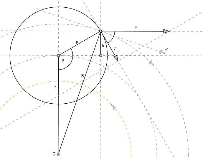

This is my attempt to work out the averaged angular velocity of the ZAMO congruence (using the paddle wheel metaphor), to see how it relates to the gyroscope precession. Referring to the diagram below
the solid circle represents the paddle wheel with a radius of p and with its centre a distance r from the centre of the Kerr black hole. In the illustration, r is only about twice as big as p, to exaggerate the approximations I make, but normally r would be much greater than the radius of the paddle wheel which can be considered to be infinitesimal. Here I am considering the point of view of a rigid frame co-moving with a ZAMO at radius r, such that faster moving ZAMOs lower down are moving to the left and slower moving ZAMOs higher up are moving to the right. The first part of the calculation is to find the velocity of a given ZAMO at an arbitrary point on the perimeter of the paddle wheel. The distance of this ZAMO from the gravitational centre (C) is R and for the calculation I am using the approximation, R=(r+h). From simple trigonometry ##h=-p \cos(\theta)## so
##R=r -p \cos(\theta)##.
This value of R can be substituted into the ZAMO angular velocity:
##\frac{2ma}{(R^3+a^2R+2ma^2)}##
Multiplying the above by R gives the horizontal velocity (v) of the ZAMO at that radius. This is an approximation because the actual velocity tangential to r is (v*) as shown in the diagram, but the error is small for p<<R. The velocity of the ZAMO frame at altitude R is then subtracted to give the velocities as seen in the rigid frame co-moving with the representative ZAMO. The component of this velocity that is tangential to the paddle wheel perimeter (v') then has to be found and to a reasonable approximation this is ##v' = -cos(\theta)*v##.
##v' =-\cos(\theta)\left(\frac{2maR}{(R^3+a^2*R+2ma^2)}-\frac{2maR}{(r^3+a^2r+2ma^2)}\right)##
This is the velocity component tangent to the paddles of the wheel at a given point on the perimeter of the wheel. This value is integrated all the way around the perimeter from ##\theta=0## to ##\theta=2\pi## to sum all the velocities and divided by ##2\pi## to obtain an averaged tangential velocity and further divided by p to obtain the angular velocity of the paddle wheel. Finally the limit is taken as the radius (p) of the paddle wheel goes to zero, because I am looking for the angular velocity of an infinitesimal paddle wheel:
##\Omega_p = \lim_{p \to 0} \left(\frac{1}{2 \pi p} \left( \int_0^{2 \pi} -cos(\theta)\left(\frac{(r-p \cos(\theta))2ma}{(r-p\cos(\theta))^3+a^2(r-p\cos(\theta))+2ma^2}-\frac{(r-p\cos(\theta))2ma}{r^3+a^2r+2ma^2}\right) d\theta \right)\right)##
and the final result is:
##\Omega_p = \frac {-mar (3r^2+a^2)}{(r^3+a^2r+2ma^2)^2}##
The known angular velocity of the gyroscopes in the ZAMO frame is:
##\Omega = \frac {-ma (3r^2+a^2)}{(r^3+a^2r+2ma^2)}##
Dividing ##\Omega_p## by ##\Omega## and plotting the result using ##a=0.9## and ##m=c=1## from r=0 to r=100 gives:
The red curve is the ratio of the paddle wheel angular velocity, relative to the ZAMO gyroscope precession angular velocity and is close to unity all the way down to near the Kerr ergosphere. This is a good match considering the simplifications I had to make. (The green curve is just the time dilation factor of the representative ZAMO for comparison purposes.)
The exact value of R is
##R= \sqrt{r^2+p^2-2pr \cos(\theta)}##
using the solution for a triangle with 2 known side lengths and a known included angle.
The exact value for the tangential velocity v' is
##v' = v*\frac{p-r \cos(\theta)}{\sqrt{r^2+p^2-2 r p \cos(\theta)}}##.
Unfortunately, the hardware and mathematical software I have available is not able to obtain a closed form solution for the integration step when I use the more complicated exact values. An exact solution also requires consideration of how coordinate velocities transform to local velocities and this is not straight forward in the Kerr metric. Nevertheless, this simplified result hints that the rest frame of the un-torqued gyroscopes is simply the averaged angular velocity of the local ZAMO congruence in an infinitesimal region.
P.S. If we equate the precession of the gyroscopes with the 'averaged' rest frame of the local ZAMO congruence, there is a potential complication due to the non rigidity of the congruence. If we had an actual paddle wheel in a fluid flow, the wheel automatically averages the flow, because parts of the wheel immersed in slow flowing fluid are sped up by parts of the wheel immersed in faster flowing fluid (and vice versa) because paddles on the perimeter of the wheel are rigidly connected to each other and the the wheel is forced to rotate a single common angular velocity. On the other hand, gyroscopes cannot be forced to assume a common angular velocity by a similar averaging mechanism, because there will then be a real torque on the slower gyroscopes, causing a torque reaction on the spin axis of the slower gyroscopes so that their spin axis does not remain orthogonal to the equatorial plane. I think this relates to the apparent *anisotropic* rotation of the gyroscopes that Peter is mulling over in the quote at the top of this post, which is at odds with the fact that Fermi transported vectors remain orthogonal to each other. Something does not seem quite right here.
