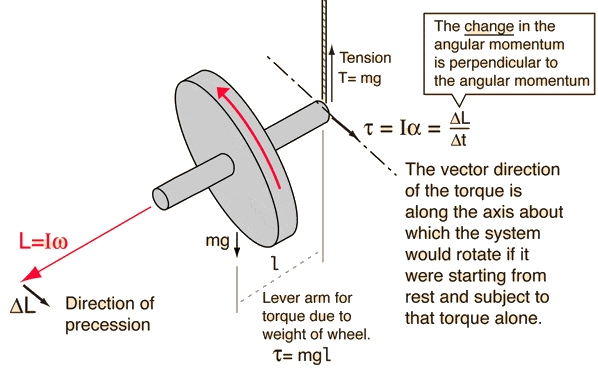

This is the experiment
I am a bit confused about this part:
There is a torque on the wheel from its own weight. That's the τ on the picture.
In this perspective, τ points at the bottom of the page. I understand that that torque changes angular momentum of the wheel and the wheel starts precessing because of that change.
What is bothering me is that I can't figure out what is opposing the torque τ so that the wheel doesn't drop as it would when it wouldn't rotate. There has to be a torque that has the opposite direction. Or does it?
Is it angular momentum that is preventing the wheel from dropping?
It's confusing because I would expect that the wheel would slowly be dropping (it's angle going from horizontal to vertical) as well as precessing. Maybe it does happen like that, but very slowly? And I am not talking about energy losses on friction.

the torque opposes itself on the other side. It's just that because of the angle it is slightly greater on one end and thus the rotation. When it starts falling it goes from having to not having torque.
No, if there were another torque canceling out the gravitational torque then it would not precess. The precession is precisely due to the fact that there is a net torque.

Torque has direction. Is the torque from gravity constant? Or merely constant in magnitude?
Torque from gravity is constant in magnitude, but not in the direction. Direction changes as the wheel precesses, it's always perpendicular to wheel's angular momentum from spinning.

Only if the torque were in the same direction as the angular momentum. This is the same as in linear motion: forces parallel to momentum increase the speed but forces perpendicular to momentum change the direction of the momentum. Similarly: torques parallel to the angular momentum increase angular speed but torques perpendicular to angular momentum change the direction of the angular momentum.

I am not certain that I am understanding your scenario. Let's assume a coordinate system with x horizontally to the left, y horizontally from front to back, and z vertically upwards, and with your right hand at the origin. So the axle is in both hands with the gyro spinning such that there is a large angular momentum to the left (+x). There is an upwards force at each hand and the weight at the center. The upwards force at the right hand produces no torque because the r is 0. The downwards weight produces a torque in the y direction, and the upwards force at the left hand produces a torque in the -y direction. The weight is twice the force but half the radius, so the torques cancel out.
Sound right?
That's right.
And then with my left hand I rotate the gyro in xz plane, some 45 degrees down. The gyro will produce torque in z direction. We rotated the gyro and it produced torque.
And yet, if the gyro is instead suspended on a thread only on one side, gravity will produce torque on the wheel and the wheel will start precessing, but the wheel will not rotate as in my first example.

Yes, you are changing the direction of the angular momentum from x to x, -z. That requires a torque in the -z direction, and by Newtons 3rd law you will feel an equal and opposite torque in the z direction.
Yes, the torque from gravity is in the y direction, not in the z direction. So you would not expect it to rotate in the same direction as a z torque.

Ah, that was my first misunderstanding. I thought that I applied torque in y direction.

I forgot that torque in one direction doesn't mean that angular momentum will point in that direction. I totally forgot that. Angular momentum is a vector and should be added as a vector.

That is the situation in the beginning. The left hand applies a torque which opposes the gravitational torque. I assume there is a handle with bearings so that can be done as you say, without friction.
