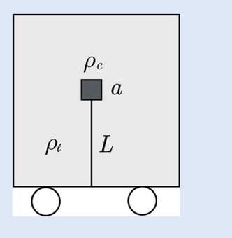

We consider the case where the wagon is at rest in profile view (below). Determine the pressure difference deltarho = rho under - delta on between the pressure under the inner surface of the cube and the pressure on the upper surface of the cube.
rho = F/A

I think I have to take the formula for pression. rho = F/A -> rho = ma/A but not sure, how to handle it here.

I thought, it should be rho under - rho above = pl*L - pc *a
Solution is: pl *g *a
ρ stands for density, not pressure. ρl would be the density of the liquid that fills the wagon. (I presume that's what's going on here.)
How does pressure relate to the depth below the surface of a fluid?
It's the length from beginning of the cube till ground?
The pressure within the liquid depends on the depth below the surface. Pressure increases with depth.
