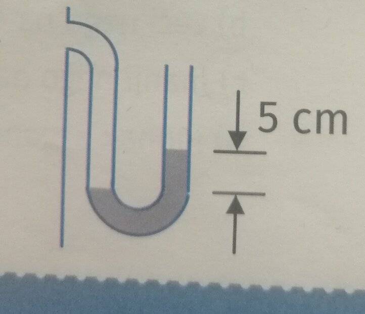

to a container filled with gas, U shaped pipe is attached, as shown in the picture(picture below). What is a gas pressure in the container if the height of the pillar of mercury in barometer is 740 mm?
pressure = density * g * height
Can someone please tell me where I am wrong, here goes the question:
The way I solved it is: pressure of mercury(740mm) + 5 cm difference in U pipe --> 0.740 m * 13600 * 9.81 + 0.05 * 13600 * 9.81 = 105398.64 Pa. But the answer at the and of the textbook is 100 062 Pa.
Thank you.

Any chance the textbook is wrong ?
I find somewhat different conversion factors, but with three digit accuracy the 105 kPa stands firmly.
mm Hg to Pa
density of Hg
(you can't find a seven digit result from a three digit factor)

Where is the 740 mm height of mercury? Oh, never mind. It's in a barometer that is not shown.
Likes Callmelucky
That is another thing, if it's gas, I guess that container couldn't be filled on normal pressure(atm), so I don't understand what does pressure outside container(thoose 740 mm Hg) has to do with pressure inside of gas?
The U tube links the outside world with the inside of the container. Ask yourself what happens to the 5 cm if the ambient pressure changes.
Likes Callmelucky and erobz
thanks, that makes sense.
