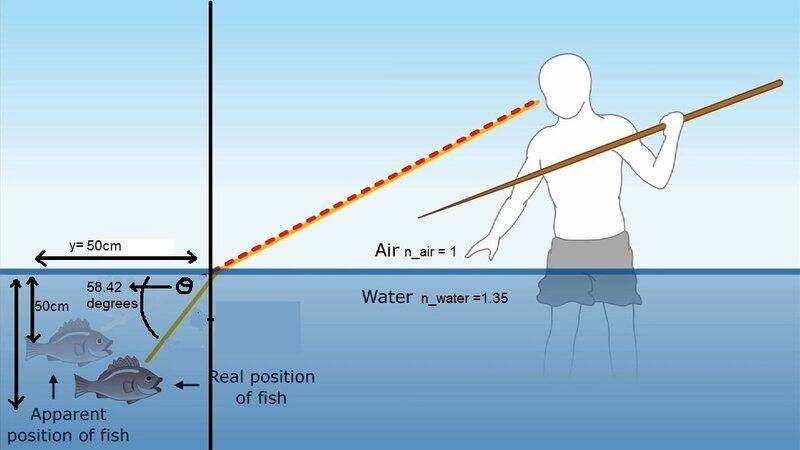

You are spearfishing in waist-deep water when you spot a fish that appears to be 45° below the water and about 50cm underneath the surface. You recognize that the light coming from the fish to your eye has been refracted and you must therefore aim at some depth below where the fish appears to be. How far below where the fish appears to be should you aim?
n air = 1
n water = 1.35
angle 1 = 45 degrees
assume a flat interface
This is a question on a past exam at university. The answer was provided (for revision purposes and exam preparation) but I never understood it and it continues to frustrate me because even if I can't come up with the right answer to a problem, I'll at least 'get' (understand) the proper answer when it is given. But not this one.
There were three steps to solving this problem as presented:
1. First we find the angle of refraction using Snell's law which turns out to be 31.58 degrees. But then we take from 90 degrees this value to get 58.42 degrees.
2. We then find what the y value is by using some simple trig (tan(degrees) = O/A) and then solving for A which is our y value in the diagram. This turns out to be 50cm.
3. Lastly we use the same formula as in step 2 to find what the x value is. x = 50tan(58.42degrees).
Now I get each part of this answer, I just don't see how it is correct. This is because the y value here doesn't have to do with the actual fish's position, only its apparent position.
If we knew either how far down or away the fish actually was, then it would be easy to find the missing value because we also know the angle of refraction. But we know neither. In my university textbook, it even uses a similar diagram of a fish underwater showing that the fish is further AWAY and DOWN from its apparent position.
So even though its true that at 50cm away and at an angle of 58.42 degrees, the x value would be 81.3cm, this doesn't actually have to do with the fish's real position. What am I just not getting here? I hope this has made some sense.

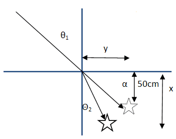

So far we have only found the angle the light ray made to the surface. To use trig to find a distance we must know a distance. What distance are they using here?
To calculate the depth, we have to consider two rays that start with a small angle between them. Then find the angle between those rays after they have emerged into the air. Tracing those lines back to where they meet under the water pinpoints the image.

As I posted, we need to consider two rays with a small angle between.
Suppose one ray from the fish has incident angle ##\theta## to the surface normal and the other ##\theta+d\theta##. These come from depth y and hit the surface at horizontal displacements x and x+dx from the fish.
The rays then leave the surface at angles ##\phi##, ##\phi+d\phi## to the normal, still dx apart horizontally.
You have an equation relating ##n, \theta, \phi##.
Can you find equations relating:
##n, \theta, d\theta, \phi, d\phi##.
##y, dx, \theta, d\theta##
##y', dx, \phi, d\phi##
Where y' is the apparent depth?
From those, an equation relating ##y, y', n, \theta, \phi##?

Thanks for the replies but I'm still not understanding it. I've gone to the trouble of presenting the answer given as follows:
Here is a picture I found on the net with some added stuff on my behalf to help visualize the problem. It lists all of the current knowns.

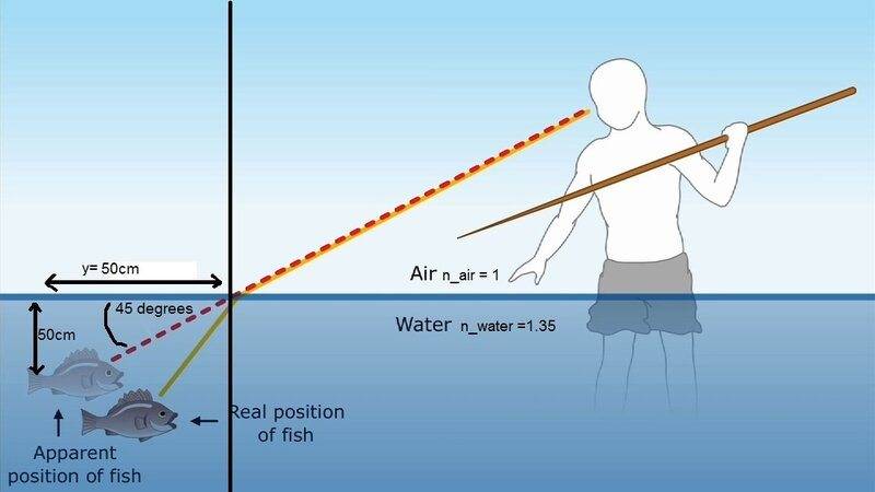

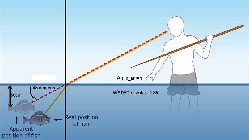

In step 2 we find the y-value:
tan45 = 50cm/y
y = 50cm/(tan45)
y = 50cm

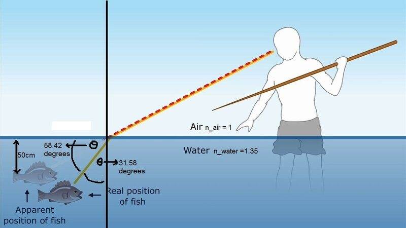

In the final step we combine what we found in steps 1 and 2 to come up with:
tan(58.42) = x/50cm
x = 50tan(58.42)
x = 81.3cm
Now my problem with this answer given is that this is true if and only if the fish was directly below its appeared image. That is to say, it actually was 50cm away. However, is this the case? Some images I've seen showing such a scenario show the fish or other object ahead (closer to us horizontally, as is the case with these drawings), directly below, or (as in the case my textbook) further away (from us horizontally). So which is it?
I DO understand that because of refraction objects appear closer to the surface than they really are but how about horizontally speaking? I've even watched contradicting videos on YouTube about this.
Sorry for my lack on not 'getting it'.

Consider the paths of one ray to each eye. Viewing the paths from above, they will appear as straight lines. As each ray passes through the surface of the water it stays in the same vertical plane. So the image is indeed directly above the fish. The diagrams are misleading in that respect,
