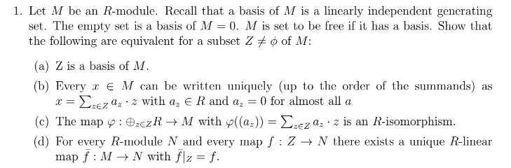

Here's the problem:
I don't see why there should be only finitely many nonzero a_z in b. I was able to prove uniqueness assuming that there only finitely many nonzero. I was able to show b implies d and b implies c, c implies a.
So you're referring to the implication (a) $\implies$ (b). There are only finitely many $a_z$ in (b) simply because $Z$ is a generating set for $M$ (since it is a basis by (a)).
