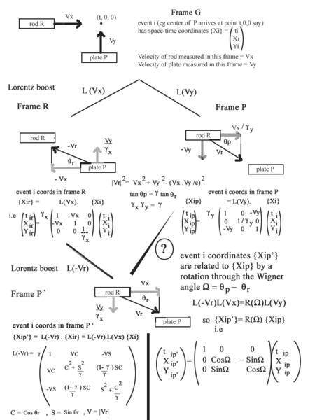

Im sorry it wasn't clear: This is what I meant: The same physical event , call it i, has coordinates t, X, Y which are different in the three reference frames G (ground), P (plate), R (rod). The {Xi} is a 3x1 column matrix of the coordinates of the event in the G frame. {Xir} is the 3x1 column matrix of the same event in the R frame , {Xip} in the P frame. These coordinates are related to each other by the appropriate Lorentz transformations denoted L(V) etc. These L(V) are 3x3 matrices eg
L(Vx)=
[tex]
\begin{pmatrix}
γx & -γxVx & 0\\
xVx & γx & 0\\
0 & 0 & 1
\end{pmatrix}
[/tex]
for the Lorentz boost by velocity Vx along the positive x axis.
γx= 1/√(1-(Vx/c)2)
i hope that clarifies the situation.
The problem then is that the apparent equivalence of the two possible routes from frame G to frame P Ie 1) a boost by Vx then by Vr or 2) a boost by Vy do not lead the initial coordinates {xi} in frame G being transformed into the same point in frame P because L(Vr).L(Vx)≠ L(Vy) So which of the two routes gives the correct coordinates of the event in frame P? Why do the two routes differ?
(im not sure why the latex did not formulate the matix -ill try and sort this out)

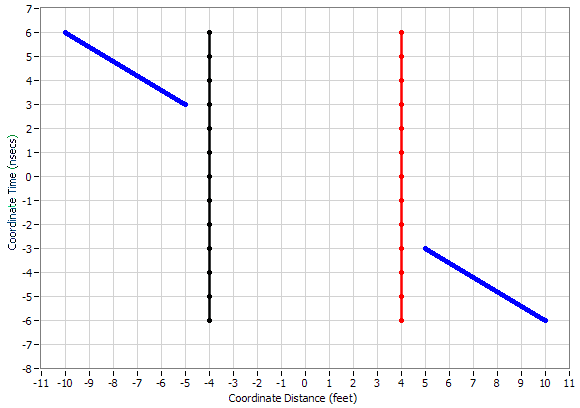

If we consider the 2D case but only look at the 1D part along the x axis, it makes it much simpler to analyze and we can draw a couple of conventional spacetime diagrams to illustrate what happens first in the frame where the rod is traveling along the x-axis and then in the frame where the rod is stationary.
I show the two ends of the rod, which are separated by 8 feet, in red and black, and the panel in blue with its 8-foot long gap. I will have the rod traveling at 0.6c in the first frame which means that its length will be contracted to 6.4 feet. This can be calculated by taking the Proper Length of the rod, 8 feet, and dividing by gamma which in this case is 1.25. Keep in mind that the red and black lines are worldlines but the blue line segments are not. They are merely showing the instant in time when the y location of the panel with its gap equals zero:

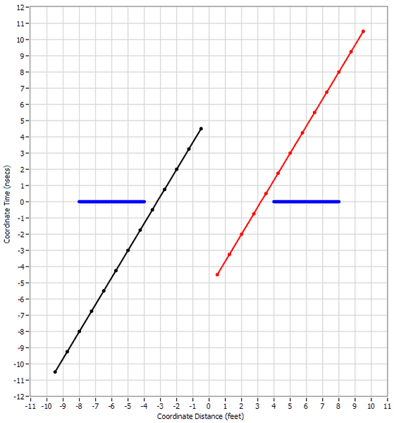

Now if we transform to the rest frame of the rod, we get this spacetime diagram:
Note that the Proper Length of the rod is 8 feet.
But also note that the blue line segments show the instants in time when the y locations of the panel equal zero. As you can see, because of the motion of the panel (in both the y and -x directions) it appears at different times in this diagram and the gap passes across the rod with no problem.
I hope this helps you find the mistake in your calculations.

Thanks for the help and the comments on the 1-d problem (the pole in a barn paradox). I appreciate how to analyse that now and how to use space time diagrams.
It was my attempt to create a similar diagram for a 2d situation comparing the three frames (ground, rod, plate) space time coordinates of events that led me into this problem of relating the coordinates in each of the three frames (G,R,P).
I assumed that if I had the space time coordinates with respect to the ground (frame G), I could find them with respect to the plate (by a Lorentz transformation L(Vx) from G) or with respect to the rod (by a Lorentz transformation L(Vy) from G). That is the case, -no problem.
If I had the coordinates with respect to the rod I could get the coordinates with respect to the plate by a Lorentz transformation along the direction of the relative velocity of plate to rod L(Vr). - again no problem (just a bit of a nasty matrix for L(Vr) if the direction is not collinear with x or y).
I thought the coordinates of events with respect to the plate, compared to the coordinates with respect to the ground say, would be the same, independent of how I generated them ( by boost along Vy, or alternatively by boost along Vx followed by boost along Vr ; since both lead to apparently the same physical situation of the plate being stationary and the rod moving with velocity Vr). After all if A is equal to B and B is equal to C then A is equal to C surely? - Well NO! not in relativity it seems!
My puzzlement arose when I discovered that the result of the x boost followed by the Vr boost ( represented by matrix multiplication
L(Vr).L(Vx)) is not the same as the boost along y (represented by matrix L(Vy)). After a lot of algebraic slog I discover that generally
L(Vr).L(Vx) = R(θpr). L(Vy)
Where R is a matrix which describes a rotation of the frame by the angle
Ω= θpr
where θp is the angle between the plate-rod relative velocity vector and the x-axis in the plate reference frame, θr is the angle between Vr and x in the rod reference frame. (my mistake was to assume both these angles must be the same as they are at low speeds, but at speeds close to light they are not the same!)
It turns out that in general the combination of two non co-linear Lorentz boosts is never equal to a single Lorentz boost, but is always a combination of a boost and a rotation.
What I've stumbled into here is well known I discover, and is called Thomas rotation and the angle Ω is known as the Wigner angle.
It's awesome that you came upon the effect of Thomas rotation by yourself but you didn't need to go through all that pain! You could have recognized the non-equivalence of the two boost sequences right from the start. Indeed if you boost from the ground frame to the plate frame then you just boost straight up and that's the end of that. If you boost from the ground frame to the rod frame and then boost to the plate frame then you would know that in the rod frame, the plate would be rotated relative to the ##x'## axis by the angle ##\tan\theta = \gamma v_x v_y## due to relativity of simultaneity so a simply boost in the downwards direction in the rod frame will certainly not get you back to the plate frame; you have to rotate the coordinate system in the rod frame by the appropriate angle so as to align the ##y'## axis with the length of the plate, so that the ##x'## axis is aligned with the direction of the plate, and then boost in the ##x'## direction by the appropriate velocity.
Yes, I missed that. I think I started out thinking that boosts could commute (which they cannot if they are not co linear) and assuming that a boost along say Vr = Vy-Vx would be equal to a boost L(Vy)L(-Vx) which also is not true!
I have attached a file which summarises the coordinate transformations in a diagram, but I am not sure how to get a picture to display in this message window.
